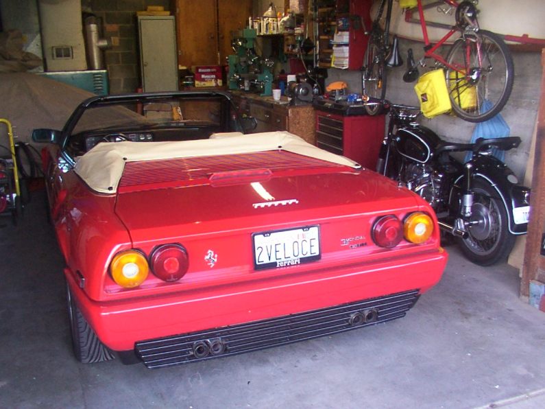

Hi Jimbo, I also have a ferrari Mondial ('88 3.2QV) cab and love it as well but it doesn't come anywhere close to my CAV with a 350hp 302. I think the difference being (other than high torque for the CAV and high hp for the ferrari) the weight - 2,300lbs for the CAV and about 2,850lbs for the Mondial. That weight delta makes a major big difference in performance. But, with the Mondial I can pull up at the restaurant with the wife and kiddies in back, top down, and, get the primo valet parking right in front - that's fun. Perhaps the most joy comes from the variation between the two but both will get you down the road pretty quick!
