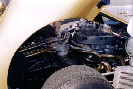

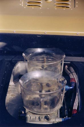

Pat...Actually the MK11's did use a pseudo turkey pan ( more a baseplate with belly band) that isn't too hard to fab...I'm having one made that will have studs on the base and holed tabs attached to the bellyband that will allow for removal of the bellyband for carb work.....if you have "The Ford That Beat Ferrari" see page 104 for the basic idea Steve

From Le Mans 2004 on Gold car No 5
