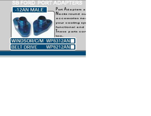

Drive belt water inlet adaptors
I am using a Danny Bee drive belt with remote electric water pump, and want to maximise the water flow into the engine.
The water pipes from the pump attach to the drive belt cover as shown in picture below. The previous owner had 3/4 NPT threaded fasteners in the water inlet holes, but I don't like that idea, and want to use proper mounting adaptors, at the maximum size I can find. The hole into the block is more like 22mm (I couldn't measure it properly)
3/4 NPT internal diameter is about 3/4"? (I'm not used to NPT) which is about 19mm. The biggest proper adaptor I can find is from Meziere (shown below), but that is only #12 which is therefore about 17mm.
Does anyone know of any adaptors for the SBF which will allow me to fit something bigger without the restriction? It seems a bit daft having 1.5" pipe from the radiator to then try and force it in 2 x 3/4" (or even smaller) holes.
Area of 1.5" diameter is 1.77sq.in. Area of 2 x 3/4" holes is 0.88 sq.in. Area of 2 22mm holes is 1.18 sq.in. Area of 2 x 1" holes is 1.57 sq.in.

Lee,
Before you change the size of the fittings why not conduct a quick experiment by hooking the pump up off the car into a bucket of water and time how long it takes to empty it with and without the 3/4" fittings. The
pump may already have internal restrictions that limit the flow.

Re: Drive belt water inlet adaptors
Thanks for the guidance so far. Not sure I can test the pump. Because it is an electric, water flows through it even if it is switched off. I don't want to reengineer. I just wondered if there was any way of avoiding the restriction at the inlet of the engine. Happy with the restriction out of the heads, which would act to increase pressure in the engine, but restriction into the block would act to create suction through the engine rather than pushing through the engine if that makes any sense. The pump is located at the front of the car, after the radiator.
So anyone know of any bigger inlets?
Lee,
As long as the outlets from the heads are smaller than the inlets [3/4"] then there should be no problem. Race motors that run a restrictor instead of a t/stat usually have a single opening of approx 3/4".
With your electric pump to you run a t/stat? If so how does the water circulate before the t/stat opens?
Jac Mac. Now we're cooking. No t'stat. I should have mentioned earlier. Now I can see the confusion. I should have said I am running Yates heads with -16 outlets.
Therefore the -12 or 3/4NPT inlets are the narrowest part of the system.
So from the pump, there is 1.5" pipe through cockpit. Then splits into 2 pipes, possibly 1.25" each. Then these go to the block. The 2 of -16 outlets join together to 1 pipe 1.5" into header tank. Outlet on header tank is also 1.5" which then runs into other pipe through cockpit which is 1.75" running back to 1.75" inlet on radiator. 1.5" oulet on radiator with short run to pump.
Pump controls temperature by running faster or slower as necessary, with temperature probe in head outlet.
I think I am happy about the flow through 2 of -12, but the higher pressure will be before the block, rather than IN the head/block. Artificially restricting the head outlets seems a backward step, so how to open up the inlets?
Lee,
The instructions that come with any of the SVO Alloy heads say to use a 3/4"-14 pipe thread & -12 fitting at the front of the cyl heads . Your -16 fittings are to large by the sound of it.
To build a bit of pump pressure in the block/heads you may be able to sleeve the 'new' -12 fittings down to approx 11/16" with a couple of piece's of alloy tube if required , but that may not be reqd with your sytem.
Thanks Jac Mac
Those -16 fittings are not moving. They are definitely in for keeps, so it looks like I will have to restrict them somehow. I want a little pressure in there relative to elsewhere otherwise the bleeds at the back of the heads won't work.
Still seems strange why there is a need for 1.5 or 1.75 pipe anywhere in the system when there is a 2 of -12 restriction at the inlet to the block and at the outlet from the heads.
Just thinking about it, the heat in the heads will create additional pressure, or have I got my high school physics the wrong way round?
