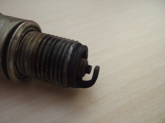

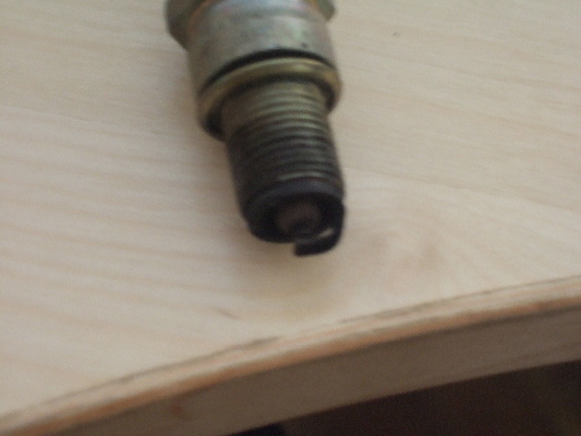

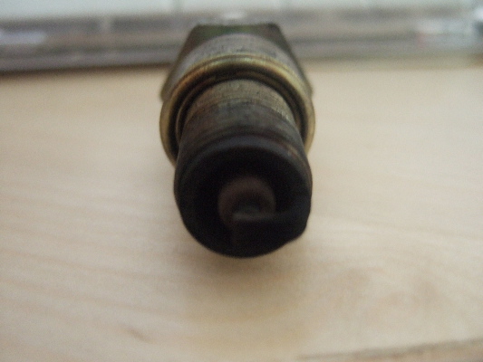

Is this Rich lean or correct?
Ian Anderson
My past experience has been on cars running leaded fuel and checking colour of plugs and exhaust gave the tune of the car away.
This is plug from number 5 cylinder on the Dax which is a NGK BP6ES in a Rover 3.9 EFi running Unleaded fuel
Rear of exhaust is black - but I know with unleaded that means very little - so he are pics of the plug
Does it need adjusted?

Are all the plugs roughly the same as this one? or did you pick this one specially.
To me it looks fine, I can still make out the white of the porcelian holding the electrode, and there does not look like any buildup on the tip of the electrode. If anything it may be a little rich, but if you only do short journeys plugs can stay dark. If you do a lot of high speed travelling you could try weakening it a notch and see what happens.
If it was darker, no white of the porcelain showing through a black soot coating, then defo too rich etc.
A CO meter is the only real test,
Ian, Did you remove this plug after doing a 'Cut' or just remove it after a run.
As Joe T has stated unleaded doesnt give conclusive readings like the "Good Stuff" used to.

Plug was chosen as easiest to remove
Car was run around the streets - about 10 miles or so, last bit (mile or so) has slow stuff 30mph and traffic lights.

Ok, I think I would put more miles on it before worrying, it does not look too lean. You are right too lean is the more expensive setting as it can cause hotspots leading to engine damage, but you normally get a lot of signs. Misfire, pinking, generally poor performance.
To put you mind at rest drop in to any garage, most have a CO tester and ask for a print out. I am assuming yours does not have a CAT fitted due to the SVA testers comment.
He might be thinking of a older carburated rover V8 and comparing your reading to that.
