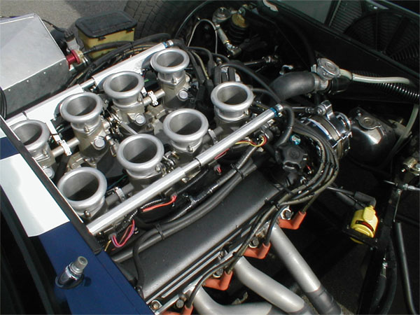

Well, some of them do manage with EFI, but the Daytona was something of a girlie-man's car.......
