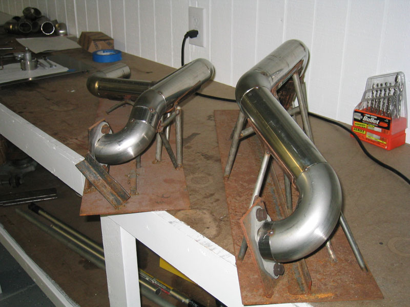

The project began with some jigs on loan from a very dear friend. The prototype set of pipes were made from these jigs using donuts and straight sections of pipe cut to fit.

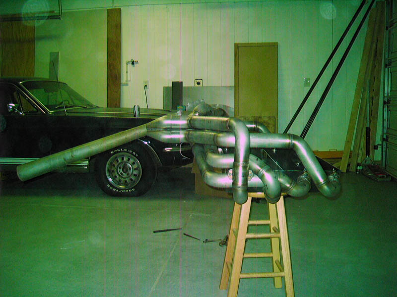

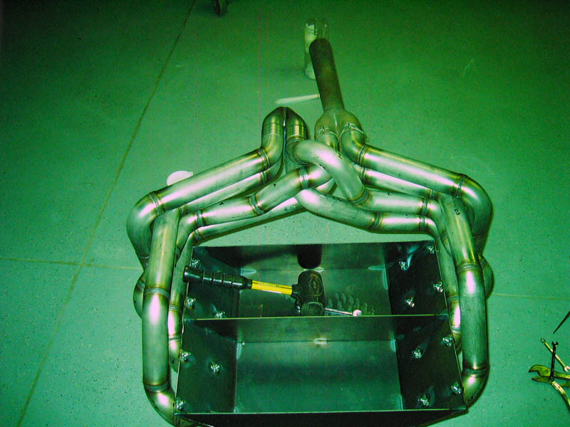

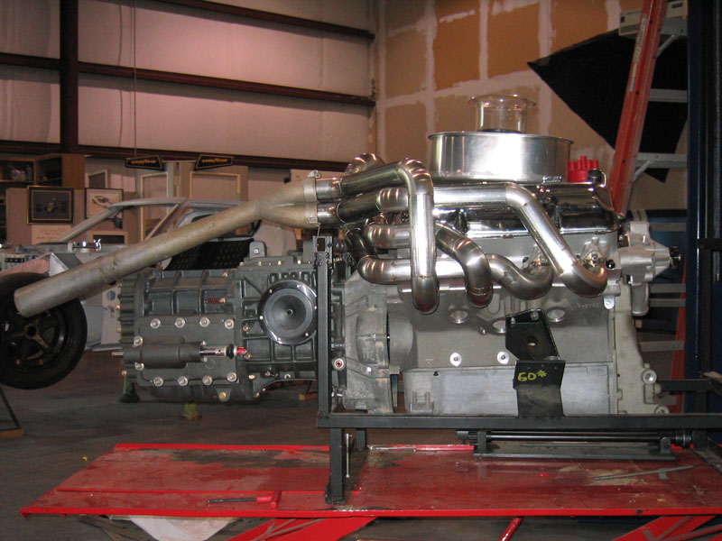

Once all 8 prototypes were complete, the moment of truth came when they were mounted to a big block complete with T44 and original collector and megaphone.
Is there anything more beautiful?

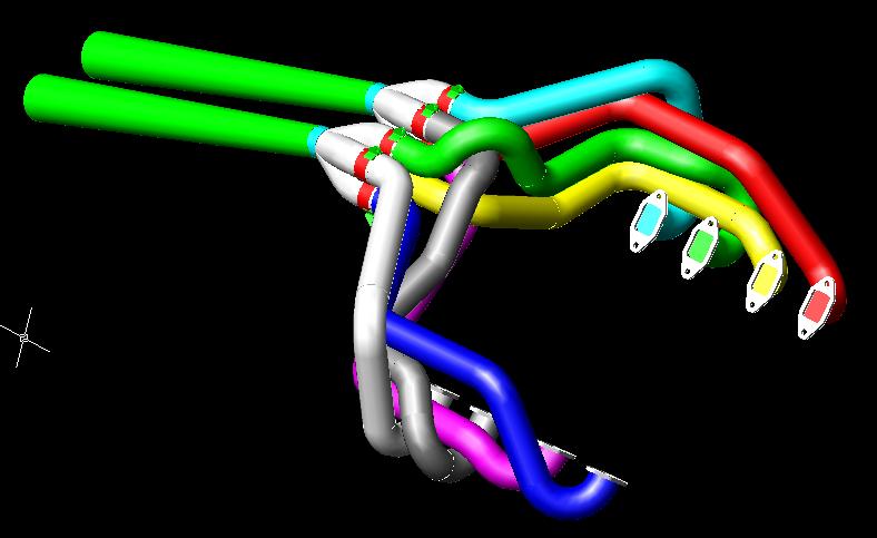

So with the jigs verified, it was time to sit down and really figure out how the originals went together. We reversed engineered the prototypes and got them into CAD. With the CAD model a cookbook list of bend sections was developed. This took MONTHS.

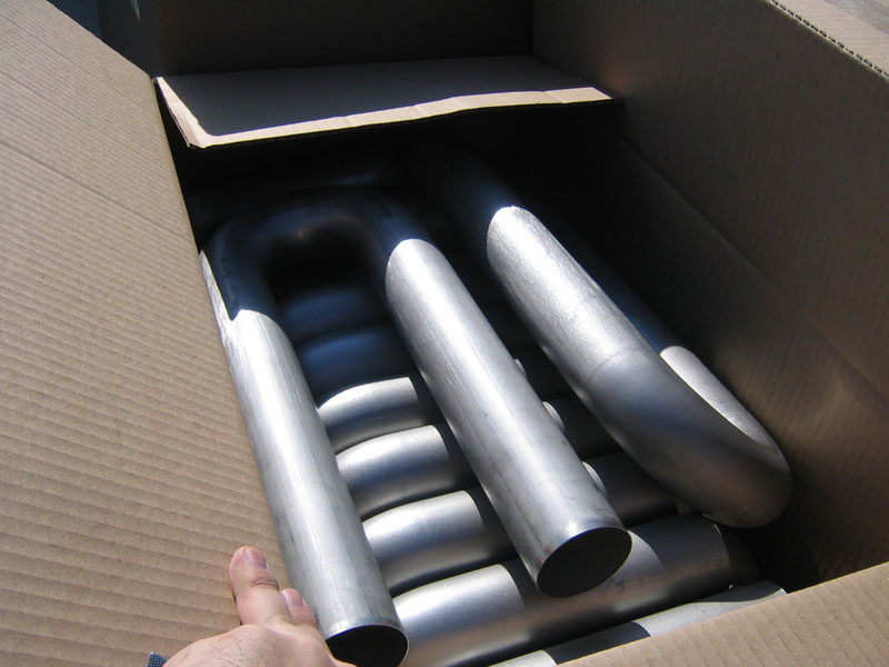

With it all figured out, we ordered an enormous amount of tubing to complete sets for ourselves and friends. U-bends allow us to get 2 sections out of one 180 deg bend. Material is 2.25" dia. 0.035" thick 321 SS bend at almost a 1D centerline radius. There aren't too many shops willing to supply that, trust me. It is thin, hard as nails, and expensive.

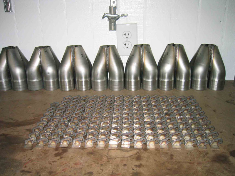

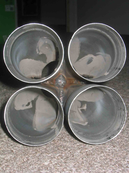

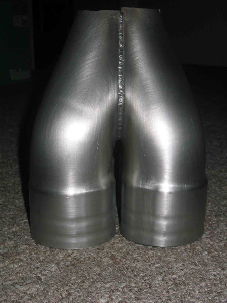

We then made the collectors. They are the merge variety and the geometry is unlike any available todyay the best we can tell. I won't try explain how we fabbed these. I dare you to weld down in there! Ever played that game operation?

We even had to design water cut, and fab the little tabs that hold the collectors and pipes together. I bent and welded like 250 of these little suckers!

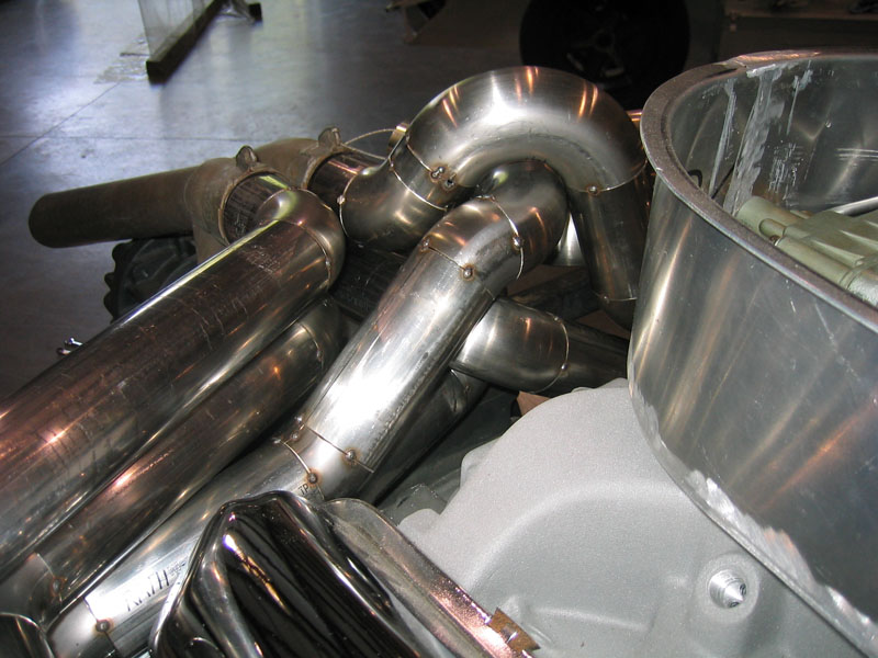

All segments are slip fit and welded as original. Cylinders 4 and 8 are two piece to ease assembly (read make it possible to assemble). The transition from round to rectangular is reinforced with an additional layer welded to the flange and pipe. That transition is 50% of the work for each pipe. Believe me, MKI pipes are childs play compared to these suckers.

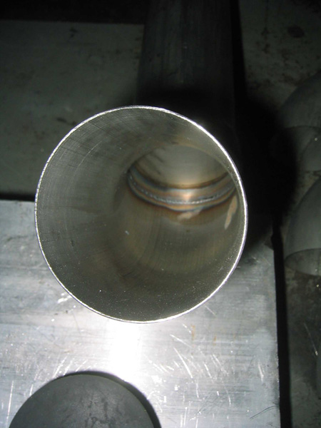

All welds were TIG with the pipes purged with argon. The result is a beautiful weld without nasty oxidation on the inner surface. The welding supply guys also got to know me real well.

I would still call my welds structurally satisfactory, but not as pleasing to they eye as they could be. A funny thing happended while spending hundreds of hours welding these things. I became better at welding thin stuff than I am at thicker material. I was doing some 1/8" stuff on the mustang the other day and just couldn't get in the groove. The 321 has Ti in it (that is what gives 321 its elevated temperature strength), which is nasty in it's molten state. You use 347 filler rod when welding 321 as well. The result is a weld that looks somewhat dirty, with what I think is the Ti floating on top. I hear that inconel is even worse in that regard. 304 actually makes the best looking welds, although not as strong or corrosion resistant at elevated temperatures. I am still a nerd, but would have surely been a fabricator if I had not gone to school. It is like art class for grown ups.

Awesome craftsmanship on those pipes, your welding and repeatability on the tubes is definitely on the money. If you are having some trouble with what you called "dirty" on the outside of the tubes I would suggest you try a complete purge during the process...an example would be a box similar to a glass bead cabinet, except for welding. We used this on titanium parts and it gave a good weld. Also you may have a little oxidation on those tubes which will also come to the top on stainless, looks like a floating skin as you weld. I can tell you that you have a superior product there and have taken pains in the details.

We did some Ti parts in a chamber back in college. I had considered it for this project, especially for the collectors. It really limits your visibility and manuverability though. I removed the mill scale from the joints and cleaned with alcohol before welding. The flanges were 304, and when welded to the 321 pipes the weld was beautiful. I think the extra nickle makes the difference. If you rub out the HAZ on the 321 however, the weld looks just as good.
We just cut the tube and bends with a band saw. The hard stainless and interrupted cut makes short work of the blades. Sometimes we even used the abrasive saw. The joints on the primaries are expanded and slip fit. This is how the originals were done and why the joints look so good. If the slip fit is made too loose however, the weld is tougher than a butt weld. You have to tack the thing together, trap the outer tube, and shrink it back down on the inner.
The collectors were marked with a fancy little template that I made, cut with a regular old cut-off wheel, and then ground on a belt grinder to make them flush and square.
