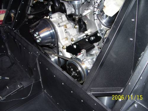

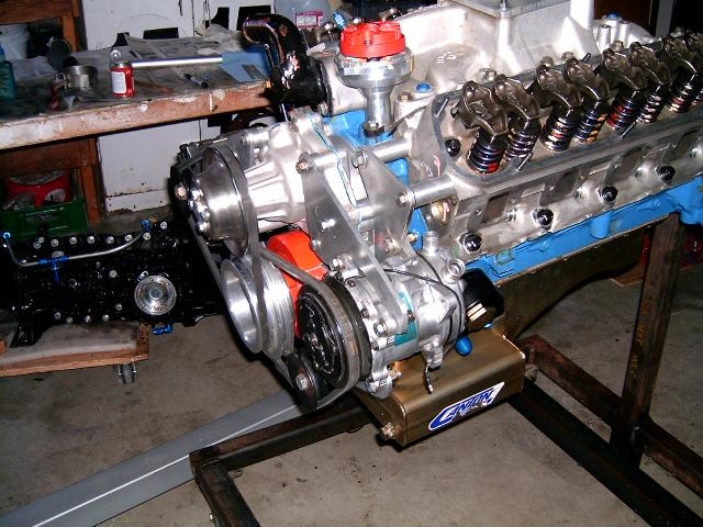

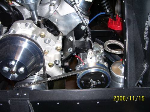

Bill,
Unless you have some obstruction around your motor front you should be able to get the compressor fitted. You might check with one of the dealers for the compressor or A/C maufacturer for proper location and bracket fitment. When I placed my order with a local dealer, he had several compressors to choose from and made the suggestions as to which one was best for my needs. They also supplied a blank piece of steel plate that they would alter to fit my engine when I was ready to have it installed. they will do all the hard tubing, wiring etc. when I am ready for that phase, which hopefully will be in a couple of weeks. They will mount the condensor,and expansion chamber and all. They do it all day on custom rods and have the knowhow. Just tell them where you want the radiator mount and other accessories that come with it and they will do a good job. I am assuming you are not going to handle that part of the build yourself. A/C problems can be a nightmare and expensive if damaged.

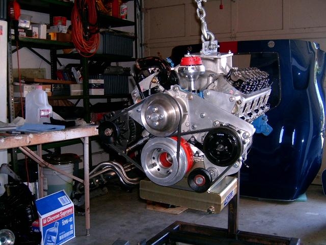

I have over the years collected pics of all sorts of parts and ideas that have been a help to me with my build. Here are some of those pics. Maybe you can find one that will help you.

Thanks Bill and Fran
I have downloaded those great pictures and will use them as a guide for fabricating my setup.

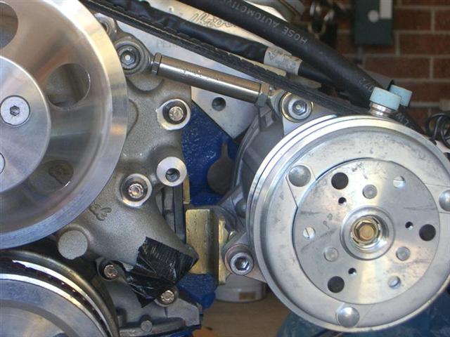

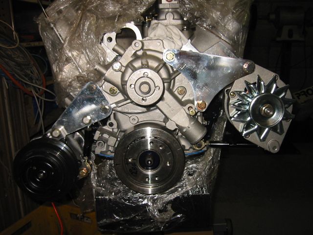

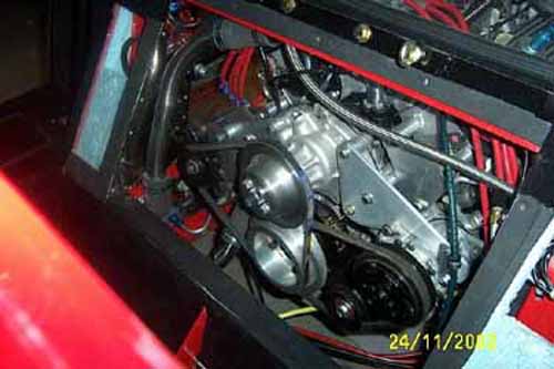

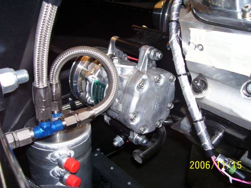

Here are some pic's of my aircon pump set up
Steve
