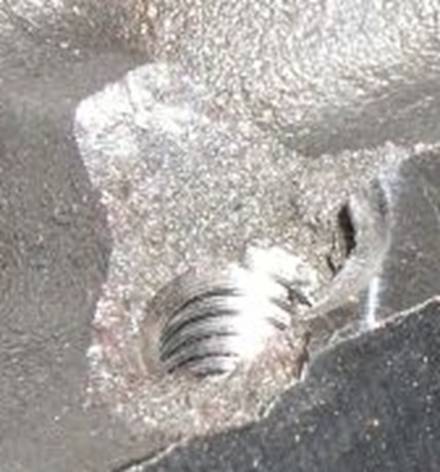

Ok, I need some help and I am hoping someone here can help me.
So FMS wants little to do with me. They told me via email that I could ship them the motor and they'd take a look at it and tell me what they think. I am hesitant to waste additional money shipping it just to have them not tell me anything different.
I asked to speak (over the phone) to the individual in charge of the disposition of things like this and he has yet to return correspondance beyond the one where he's told me FMS will do nothing for me at this point.
Has anyone ever had a similar experience with FMS? Did any of it have a happy ending? Can anyone recommend an effective course of action to get some sort of satisfaction?
This whole experience has left a sour taste in my mouth. The debate over hiring a builder vs. buying crate motors has been officially concluded in my mind. Next time(?) I will be going with a REPUTABLE and reliable local resource. Doing it this way was supposed to reduce hassles.
I also finally posted a few more pics (but can't seem to get them to appear in the post)-
a general layout:
a close-up of the failure:
http://www.gt40s.com/gallery/file.php?n=366&w=o
what it's supposed to look like:
http://www.gt40s.com/gallery/file.php?n=365&w=o
an "exploded" view:
http://www.gt40s.com/gallery/file.php?n=367&w=o
a close-up showing the grain structure as best as I could manage:
http://www.gt40s.com/gallery/file.php?n=368&w=o

Chris
Roger had another look and responded thus
Ian,
Having looked at the pictures there is one that I think is relevant in that it shows evidence of a casting flaw.
It's some distance from the bolt hole but nevertheless cannot be ignored.
See my attached pictures.
The other pictures don't show anything revealing and the broken bits don't show signs of flaws.
However the picture of the bolt suggests that about 10 threads were engaged, which would be thought to be adequate.
The maximum stress in a clamp-bolted connection is in the first thread, diminishing with distance. A flaw in the vicinity would reduce the strength locally.
It might be feasible to do a weld repair, building up the metal and grinding flat and retapping the thread. However, the angle of the seating face would need to be about right.
I think there is a legitimate grievance here because I think there is evidence of a fault in the casting.
However, as with all cases where the enemy dig their heels in, the cost involved in pursuing it would probably outweigh the benefit achieved. Matters of principle cost money but they also reduce the life expectancy!
That's what I think, anyway.
Roger

Chris, you are stressing too much about this, assemble the thing with some studs(maybe a longer one in that location) torque it down and see what happens. The torque is very minimal on those bolts and I don't think that you will have a problem, if it fails when set up that way than I don't see how FMS can deny your claim. I don't think you will have a problem, I think your bolts were too short.

I agree! Stud it and forget it. FMS won't do anything for you except make you more frustrated and cost you more money. Unless you send it back to them if they will pay the shipping both ways. Ya, like that will happen. This is why Ford is in trouble it doesn't give a damm about the customer, just their bottom line, which is shrinking because of stuff like this. It's always the customer's fault no matter what. Never Ford's fault. Ah, I feel better now.

Just a quick update.
I was quick to berate Ford for inattentive customer service, but they did agree to ship my motor back on their nickel and take a look at it. I'll see what they say about it now and if all goes well I'll actually get what I paid for.
I dropped it to Anthem 12/28 and they shipped it 1/3. I have yet to hear back regarding any disposition. As you can imagine, I am anxious to get my hands back on it now...

Because there was no real damage to the mating surface, if worse comes to worse and FMS does nothing then stud it and forget it.

That's exactly the plan, but I felt compelled to publicize that Ford agreed (eventually) to actually take a look at it.
If they do nothing except ship it back to me then I will stud it but it is worth the time t
