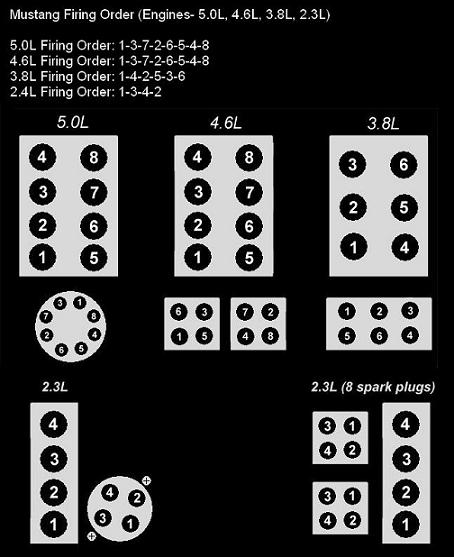

Just wondering if anyone would know the firing order of a 4.6L Mustang Cobra motor (year 2000) and also the piston count(left to right, back to front). Need this to wire computer. Any help is appreciated.

1 3 7 2 6 5 4 8
