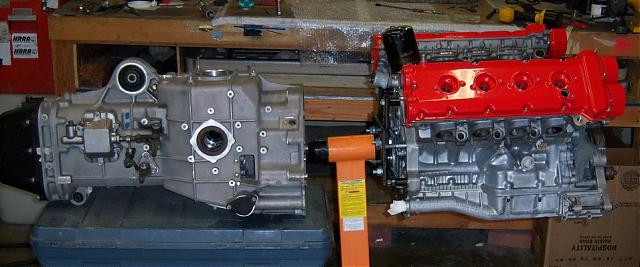

Over the holiday break I picked up this little jewel. It’s a Ferrari 360 engine and six speed transmission from a totaled Modena. Since the engine had been sitting a number of years the engine needed some serious cleaning up, so I attacked it with degreaser and a power washer right off.
First impression – the plating on the fasteners and pulleys is crap. Most of these components were corroded to some extent or badly discolored. Since I absolutely hate wrinkle finish, I stripped the valve covers with much joy in anticipation of a nice glossy Ferrari red powder coating, yah baby, maybe I’ll toss in the pulleys to match.
The second step was to pull the heads and pan for inspection and check of the clearances. Engine appears to be in good shape internally with only dirty oil to cause any concern. The original owner was a little lax with his oil changes judging from this example.
After inspection and comments regarding on the multi angle 5 valve arrangement, the corresponding cam lobe angles and the hand ported appearance of the intake tract. The next thing my engine builder said was “there is room for bigger pistons in it”. Oh brother here we go.
I plan on using a Pectel ECU to operate the engine and fuel. The system is capable up to V12 and can handle fly by wire throttles and traction control, cool. Speaking of throttles I’ll probably use a custom rack or convert big bore motorcycle units in place of the stock (heavy) intake system. This will require a custom made set of manifolds but that should be simple enough, I’ll paint the intake manifolds red too.
The engine, less the variable length intake manifolds, a/c pump, clutch and exhaust manifolds weighs 381 lbs with 1.5 gallons of oil in it. The clutch pack weighs 30 lbs, the intake about 40 lbs, each exhaust manifold 15 lbs. The transmission weighs 190 lbs without the starter.

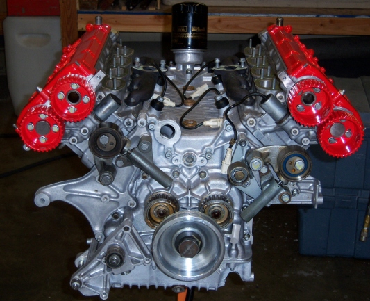

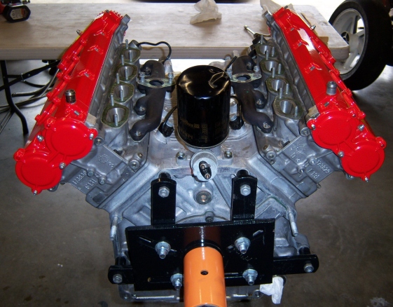

It's been awhile since I posted to this thread. Early last year I ordered an SLC from Fran and my thought was to use a BBC or LS7 in that car, so that meant I didnt spend much time working on this package. But a year has allowed for some good progress, I replaced damaged parts on the transaxle, bought missing items and added the cable shift levers (it was a F1 paddle shift). I cleaned up the engine and heads and true to my original thought, painted them Scuderia Rosso.
Five valves per, anyone?
I dont have the intake as I planned to use ITBs, no alternator or A/C pump, needs timing belts and belt covers. I have entertained the idea of selling this setup so if you have a need, drop me a line, I will fill you in on the more specific details.

Oh how I hate the crinkle finish.... the 360 has gray crinkle so it looks even more like a tool box.
Powder coat. If I end up using this for something I'll coat the (yet to be made) custom intake manifolds red and the end of the tranny too (now black). Would be a nice detail poking out the back of a car that you see the gearbox in.

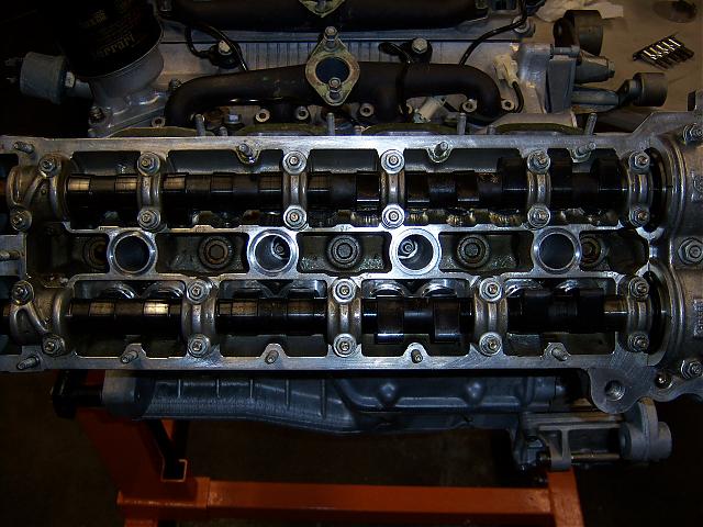

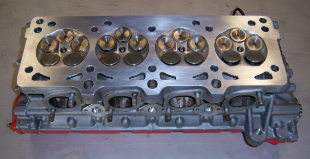

5 valve head?

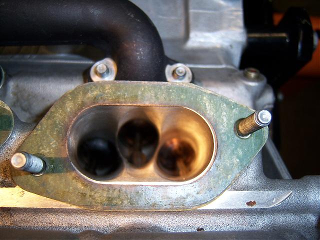

Does anyone have a picture of what the followers look like in the 5-valve head? Any detailed pictures of the head with the rocker covers off? Also what does the intake port look like?

Foster - Not the best pics but here you go, no followers - direct action. Intake ports look just like my OW01 and R1 Yamahas....The whole head looks like a Yamaha five valve.

That intake port is pure art. Is that untouched from Ferrari or has a head porter been in there?
Hi John,
The porting is stock and I think those valves are titainum. The engines have a hand built feel to them. The really trick aspect of the cam/valve relationship is that the outside intake valves are canted to the center (hemi like) with the cam lobes ground at an angle to match. That's got to be expensive.
That is a work of engineering art. Very cool. What kind of lifts can manufacturers get off direct acting cams? Also what is the black manifold for?

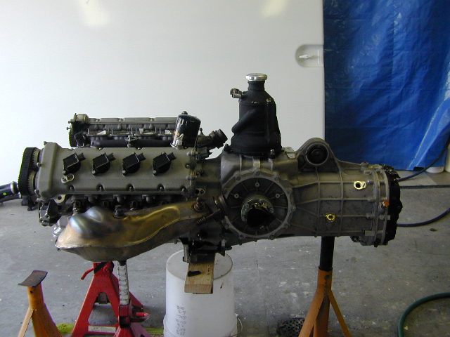

I must've missed this thread last year but I'm glad I read it today. That's a nice setup. I assume it's a flat-plane crank? Is the OEM Ferrari exhaust a tri-Y setup?

Foster - I have no idea on lift, the manifold is for water.
Mark - Flat plane. I cannot comment for sure on the collector as its covered buy a stainless housing and exits as one pipe. One for each cylinder bank, but my guess its a four into one. PM to be sent.
