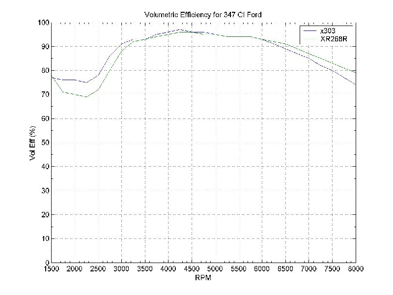

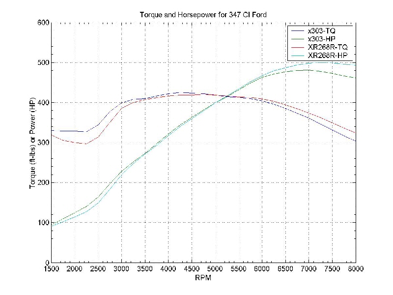

Adam Christian had access to software at OS that would do this, but I don't know if that is still true or not.
Here are some charts he ran for me with AFR 205s, the Jack Roush intake and a couple of different cams for a 347 w/3.25 stroke & 4.125 bore:
