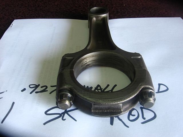

Peter,
These rods are used in original GT40's.
GT40 part number GT10 / P /3/ 3777
289/302 XE engines use them as well as the 255 Indy and TransAm engines.
Those rod bolts are hefty like my friend JacMac says.
Pardon me for saying this but : your nuts don't appear very sharp in your photo.
So the special socket he mentions is to fit the nuts in my photo.

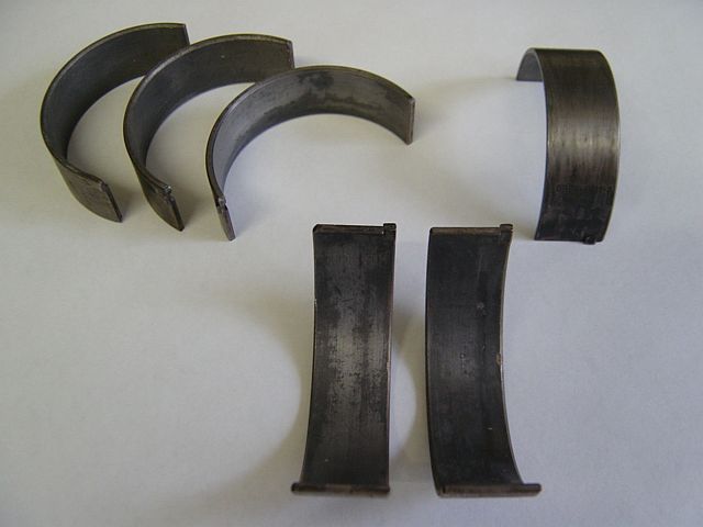

Also the bearing shells are different, part number DOZX-6211-A B / CLEV T-77
ID:	17447   Click image for larger version
Name:	SK Rod Bearings.jpg

Thanks for your concern James. Just had a closer look at my nuts and they definitely are not sharp however they do require the special toll as described. By the way, I knew that I had seen a photo of the before and just found yours in the original parts gallery. I should have looked harder the first time.

If you need a socket to work on your nuts, it was available from; Allen Manufacturing Corp, Order Department, Drawer 750, Hartford, Conneticutt. 06101. Ph no was 203-242-8511. This info is like your rods & nuts, historic!
