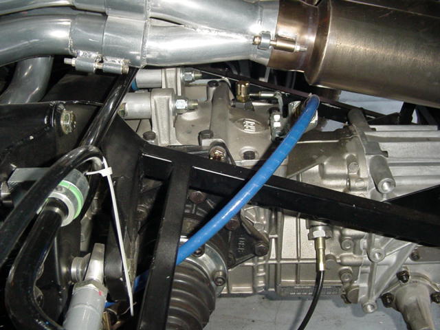

tail pipe hold-downs
Rather than cut out and weld supports to the mufflers, I’d prefer to use the spring hold-down type similar to these in this photo posted by JerryD. of his very nice Mk II.
http://www.gt40s.com/gallery/index.php?n=353
Is there a source(s) for these, or are they custom fabricated?
John

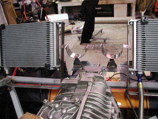

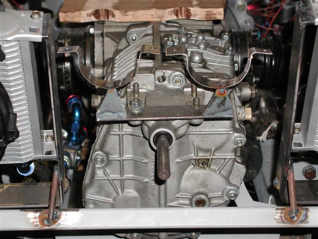

Okay, from all you guys have said, I think my best option is to fabricate a support piece that attaches to the transaxle and cradles the mufflers from below and uses springs to hold them down snug.
I've been trying to locate the sort of band clamps that were used in the photo posted above to clamp the primaries to the collectors. With singular lack of success. Does anyone know of a source for these?

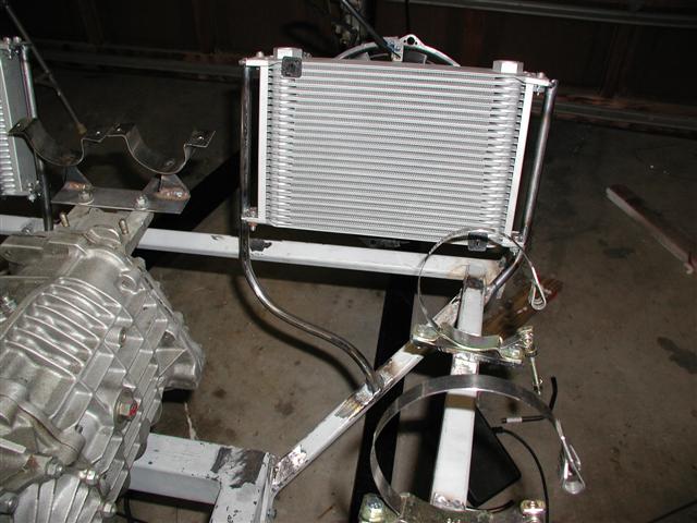

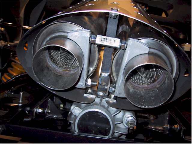

I orginally wanted to use the springs and started out with this arrangement in the first photo. After I got my mufflers, the shop guys showed me the stainless Tbolts and I have since changed my mind and am going to use the slip fit like Rich's on the front and attach the T bolts obtained from the mffler shop at the rear with a fabed bracket mounted like the one I started with on the inverted base. You can also use the Tbolts that have a base on them like the ones that come with the Accusump as seen in the side pic. Its all a matter of alignment. All shown here has been removed, cleaned up, and ceramic coated. Just awaitng reinstall. If you are going to use a heat shield there are lots of ways to do it. Here is one. I think it is Neals and is a neat arrangement.
Name:	P1010286 (Small).JPG
ID:	17693   Click image for larger version
Name:	P1010289 (Small).JPG
ID:	17694   Click image for larger version
Name:	P1010355 (Small).jpg
ID:	17695   Click image for larger version

A lot of great ideas here! I've ordered a pair of Gibson Superflow race mufflers, so I'm off to the shop as soon as they come in. I'll post a pic when they're done.
