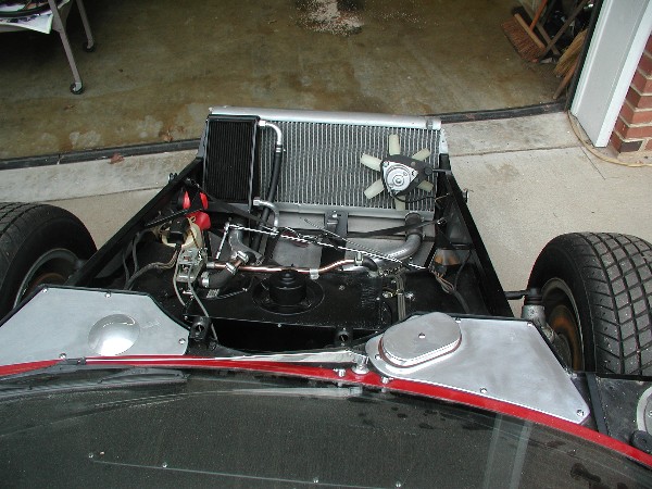

John,
The original road cars had a small oil cooler mounted just behind the front radiator. The hoses that connected it were at leat an-12 of larger. Don't know about the racecars. Someone more in the know would have to chime in.

Here you go;
Regards - Randy
