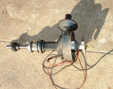

I have finally got hold of a 1965 Autolite distributor which has been retrofitted with a pertronix electronic ignition pickup. It also has a vacuum advance fitting. I know I can retrofit it to a dual point and take off the vacuum advance but what sort of electrics was used on originals... I know that this is not an original style of distributor used (last one I saw went for over $4000) but its as close as I'm willing to pay for....

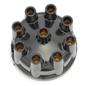

I am also getting the Autolite cap shown...
If I take off the vacuum advance and install 289 HiPo dual point internals would this be a distributor which would be considered 'period' as I'm striving for as original as (fiscally) possible for the car.

If you can find Dual Point Distributor Kit. pn DOAZ-12A132-B it will fit in that dist ( this kit included base plate-points-condenser- and several springs etc.). Points and condenser were common Autolite items ( C3AZ-12171-A for each set of points ). Similar to some english Mk 4 Zephyr/Zodiac, Mk 2/3 Cortina Granada, Transit V4 if I remember correctly. Dist in pic may not have the 'correct' 13deg plate assy for mech advance but a good 'older' sparky tech should be able to handle that for you. With todays fuel etc you probably wont want too much initial advance anyway. A 13deg cam with 8deg initial advance will give you 34 deg total.

A dual points conversion plate were commonly available via Mustang vendors, fits all small block dizzy's for around $20.00. "Pro Products" (now out of business) made them in Taiwan, but not bad overall. Some vendors still have them hanging around. And you can get a Pertronix conversion for the dual points!

Also be sure the cap has brass contacts, later caps and some reproductioons have alloy contacts that don't hold up like brass.

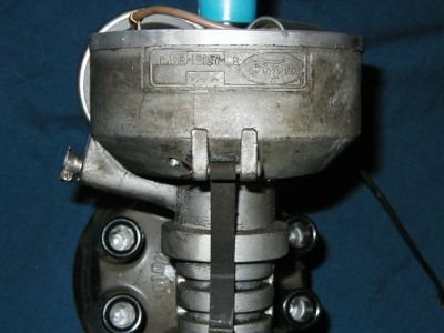

Andrew,
This distributor is good for a standard 1965 onwards Ford engine. But not a HiPo.
The original XF distributor racing core was based upon the 1964 1/2 Fomoco casting and made in a magnesium alloy. The original cap was either Fomoco or Autolite marked internally and with the number "1" cast on the top as an index and did not state "Autolite" or Fomoco externally for that matter. (see my photos or the early Mustang distributor shot below)
The bowl is different (more like a chalice) and the oil inlet is missing from 1965 onwards also tacho drive gear housing is missing.
Later cars used a chipped GT350 Ford regulator with the dual point distribution instead of the usual transistor kit if I am not mistaken.
Some guys reckon that I am anal about detail but there you go - for what it's worth.

Thanks James, the Autolite cap shown above has aluminium contacts and thanks to your info is incorrect, I have located brass contact caps and have ordered order one (brass contacts with a number 1).

The photo refers to the shape of the core with the oil feed as discussed and not the cap.
