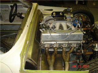

sorry, stayed low tech with "old" c3's. 435" windsor with 10.5 cr and fairly mild hyd roller got 649 bhp at 6300 with single 4bbl holley. carl wegner built the engine for me. great guys.
rd

not with me, out of town right now. it's a hydraulic roller. getting lazy. imho, d3s would me not an advantage in street or track day use, only a full on race effort.
when i get home, i'll post the cam info and a dyno chart.
rd
