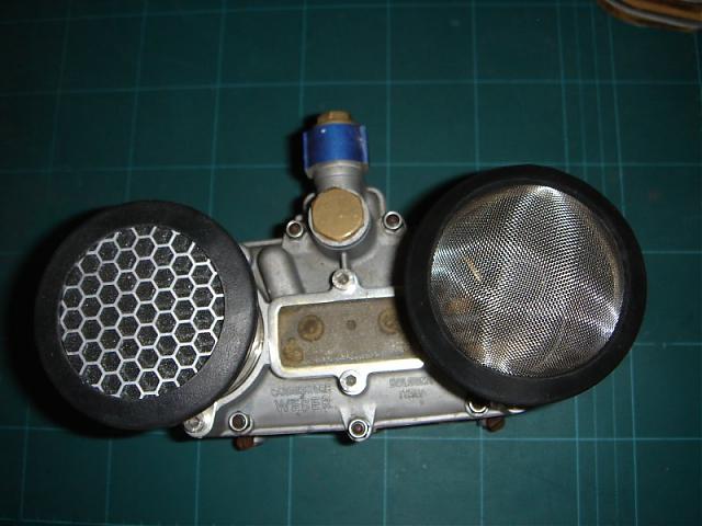

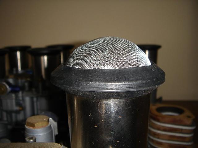

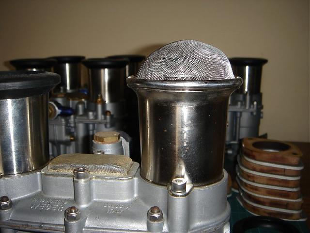

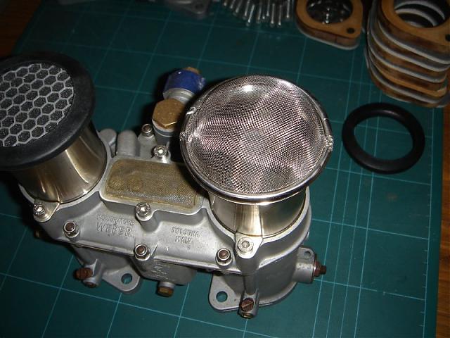

Jim, for me its looks and limited functionality, agreed the best thing to use is a good quality filter to protect the engine, but in my opinion, dosent look the part. A mesh will prevent 'relativley' large debris from entering the engine, it would help having a filter element inside the rear scoop entrance on the rear clip although air will still come up from the engine bay which wont be filtered. Depends on how good a fit the turkey pan is. But thats another thread.
Ok that said its been more than an hour........
Removed the handles off one strainer and ensured that all sharp edges were removed. Used a carbide 'cutting' disc on the dremel (dont forget the safety glasses!!!)
The rubber holders for the filters that I have do hold the mesh in place (first two photos), the second two photos show only the strainer sitting on a 48 IDA stack.
I think I prefer the look without the rubber holder and will now have a go at wiring them on.... to me it looks more...... '60's
Andy

I tried the Ingles ? rubber ring setup that Andy shows - it was an expensive disaster. My trumpets were 5mm smaller in diameter than the Webers that the setup was designed for, I heated the rubber rings before mounting (as recommended) - & yet 3 of them split with only 20 mins of driving ! So, I am running the trumpets "naked" for the moment.
I also remember a thread/post which indicated that they cost you some 30hp - when you look at how much the rubber ring interferes with the air flow, its not hard to believe.
I might have a problem with the height of the hemi-spherical mesh setups suggested, so I am looking at a flat sheet of such mesh, held in place by a simple aluminium ring with 4 little tabs. The tabs will point vertically down, and could be bent slightly under the rim of the trumpet mouth to secure them.
Seems simple - anyone see any flaws in this idea ?
