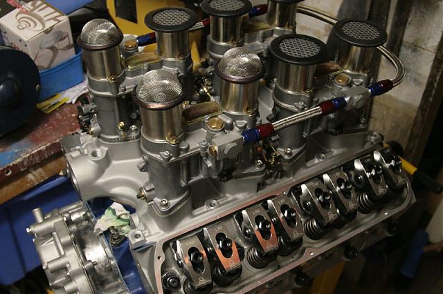

Was installing the tea strainers on my TWM injectors. I kept thinking how to attach them. I was considering safety wire, but didn't want to have the twist exposed to catch the fingers when adjusting the linkage etc. Didn't like the glue or calking idea. Then It came to me once I had removed the retainer with a dremel tool. The hole is the same size as a small rivet. Popped a hole on the oposite side and it was an easy attachment. The rivet is probably a 1/4" lenght grip, which is probably longer than needed. I had rather be a little long than short with these. If it works loose it won't come completely off. The TWM units have a full roll at the lip and the rivet is hidden from view.

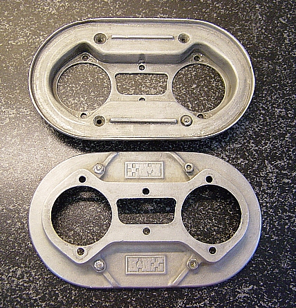

I will not use individual screens but instead the early Weber filter boxes shown below. (bottom section of the box)

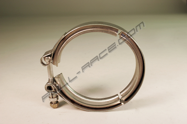

The other photo is a ready made ring clamp.

Not meant as an insult, as you post nothing but the best. Your ring clamps are another example of that. That being said, I will keep my $0.10 rivets in favor of the $25 clamp from Full-Race.
Full-Race Motorsports LLC "Everything Else is Half Fast"
That would be $200 for the 3" 8 port setup.
If you want the best, I guess you have to pay for it.
DRB#5

The ring clamp photo was just to continue the empirical thinking.
I am sure it's easy to tool up to make a less expensive version of that part.
For example a tube bead former will roll the inner rings easily.
I do have one concern however and that is whatever you fit please make sure it won't come loose and foul your throttle mechanism.

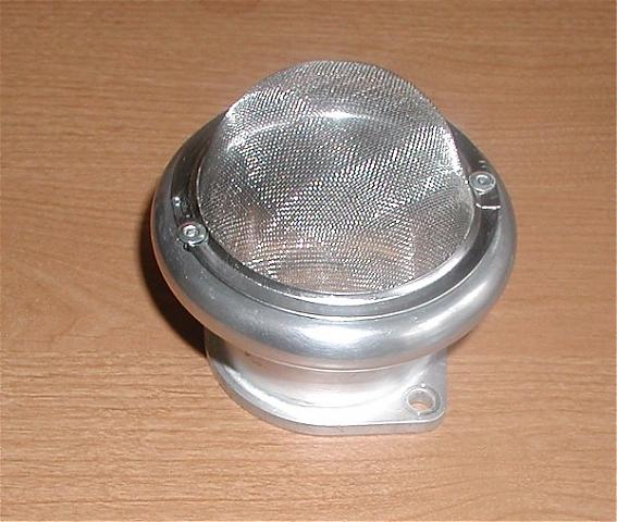

I found this guy on eBay, he does a lot of different sizes and different color lips and can do custom sizes also...
eBay Motors: Velocity Stack Filter 2.50/64 mm Full Race Version S/S (item 150171905433 end time Mar-12-08 10:39:23 PDT)

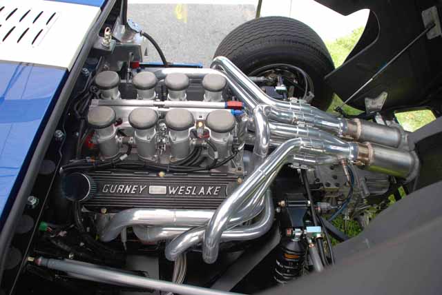

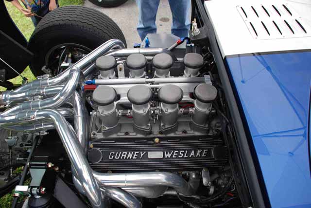

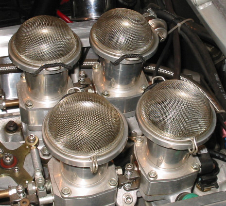

I've been reading this thread with great interest for some months now with an eye to finding some solution for my TWM 'nostalgia' velocity stacks other than the soda-can style filters that Roush and others use. My concern regarding the tea strainer route has been over whether they will filter out sand, grit, and the like.
The car is a few weeks from being delivered, and since Olthoff Racing was displaying my car at Barrett-Jackson – about an hour from home – I decided to try the same fellow UK Tony mentioned (Bob of BBR Filters: (586) 883-0942; eBay Store - bills-b-racing72:). He makes a nice product, custom fit to your stack, and uses a tea strainer-sized mesh that envelopes a micro-sized mesh that is supposed to filter out anything larger than two strands of human hair. Nice compromise.
Well, he delivered them in a couple of days (at $39 a pair + shipping). I drove up and installed them, and the consensus is that they look great and will probably breath better than the perorated disks with sponge-like filter material that came with the injection system. I'll follow-up after Dennis has dyno-tuned the engine. Anyway, take a look for yourselves – I've attached a photo I took earlier today of the engine bay.

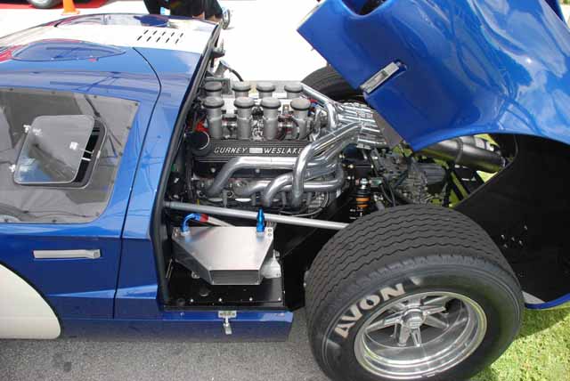

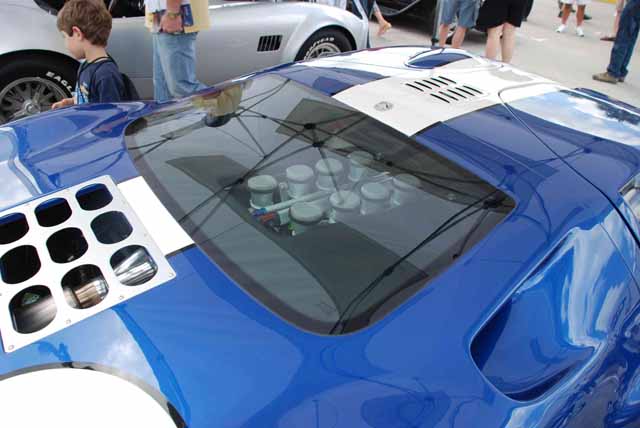

Here are some other photos of the engine bay with the new screens:
