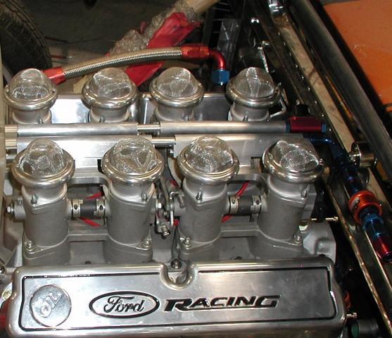

We have filter screens we sell for our injection (TWM). The weber type with the 2 screens and a layer of foam were to restrictive. When we ran them on a dyno there was a 80 to 100 hp drop with the weber screens. The ones shown in the attachment are 2 layers of screen that keep out most things we come across while driving. I don't drive my car in dusty environments anyway, and they are easy to clean. The hp loss on a dyno is almost nothing. On the TWM airhorns we have machined a 40 thousanths deep, 1/8 inch wide groove in the mounting flange of the airhorn. We put a piece of round #14 304 stainless mesh in the groove and bolt the airhorn on. We can put another round piece of mesh inside the airhorn on top of the secured mesh. This filters and does not detract from the looks of the airhorn. More ideas, hope this helps. Al

More pics of the above

Tim, You have a very nice looking car there. Now I can connect a name to the picture. I'll post a picture of the horns with the screen in the bottom, a different look that doesn't obstruct the full view of the horn. If anyone wants the type of screen pictured, they come in different sizes. Thor Motorsports - TWM Induction Authorized Dealer - Competition/Street Fuel Injection Systems and Accessories

Here are the pics of the machined airhorn.

Yuji, Are the horns too close together on IDA webers? If so the screen maker said that he could make a one piece retainer to retain 2 screens if there was less than 3/8" between the horn tops.

Yuji, The filters work as is on the 302. There is enough room. Al

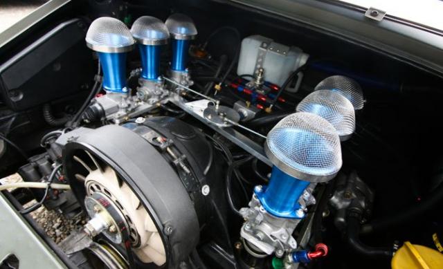

Nicest units I have seen, out of Japan.
Ill try to get some info.
cheers
eric

Eric - Those look VERY nice! I will be interested in seeing the price and availability of those...
I'm in the process of ordering parts to copy Rob's (Vintage Venom) screens using 2.5" Tea Infusers and rubber rings cut from a steering rack boot...
