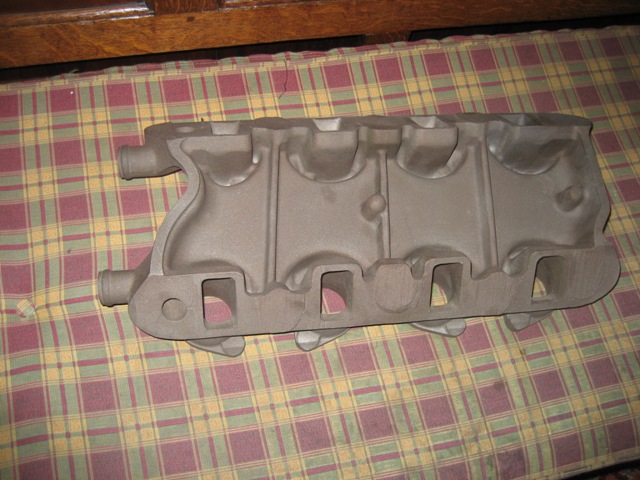

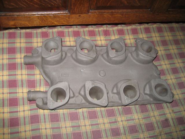

The magnesium inlets are now in production. A suitable inhibitor can be put in the coolant to guard against corrosion or the manifold can be ceramic coated. The inlet is to original GT40 spec. (photo attached - sorry about the background - it was the only one available in the pub)
The first batch of ten are now available either as the bare casting at about £700 or machined with helicoil inserts at about £850. Ceramic coating would be extra.
