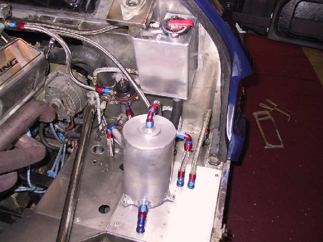

Pat, we had several issues with the CAV cooling system, and the advise you have from all of the above is valuable. We also ditched the existing expansion tank and made a new ali tank more as original, at a much higher level to assist air bleeds. We also found it essential to alter or add air bleeds into the radiators that were above the full bore of the coolant pipes, the original CAV position of bleed pipe back to the expansion tank is set too low to ensure that all trapped air is removed from the top of the rad, and thus preventing full flow through the main service pipes.
Name:	CAV EXPANSION TANK.jpg

Thanks Frank - I did also recently install an aluminum resevoir and positioned it higher than the stock CAV unit.
As to the bleed at the radiator - as part of the bleed process I jacked up the left side of the car which raised the bleed point substantially above the full bore of the right side coolant pipe.
Pat
It occured to me that perhaps something as simple as installing a 3/16" restrictor in the line from the t-stat housing to the resevoir may be all that is required?
CAV #80, 331 Keith Craft, RBT Swift DB5
