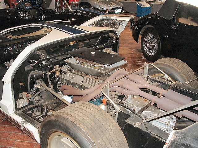

The engine paint I use is.
Duplicolor DE1601 - Ford Blue
You can just about see the original block colour in this photo

Cordially,
