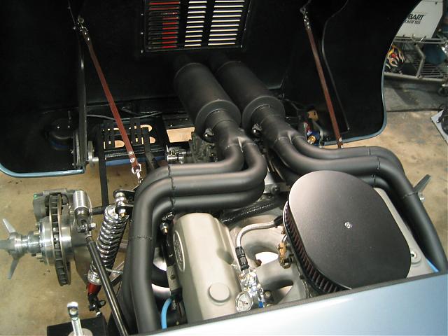

Re: What type of exhaust coating?
I like ceramic coating in Matte Black also!!!

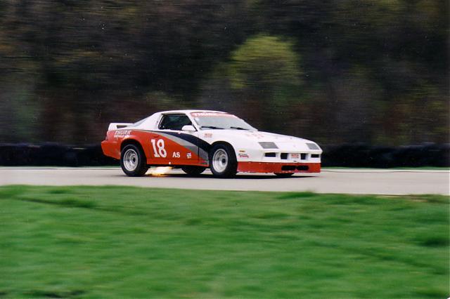

This is my old SCCA A/S Camaro.. Exhaust system is wrapped front to rear...
This shot was taken during the 3rd to 4th gear shift at ~6800 RPM..
When decelerating, the flame would light up the whole undercarriage in broad daylight.. More than once I was called to the pit-steward after the race to listen to complaints about how my car looked like it was going to 'SPLODE!!!

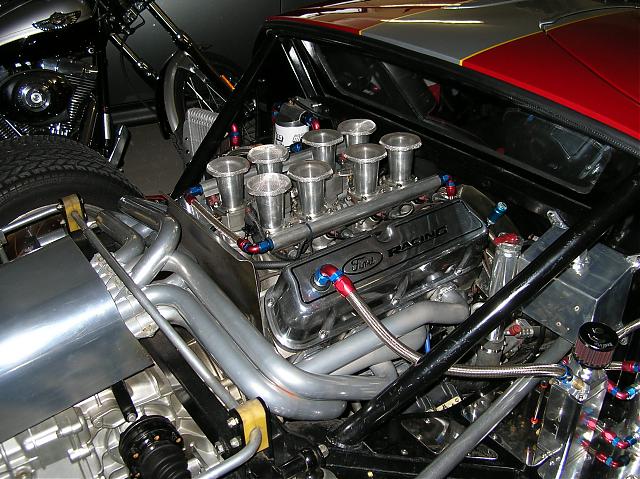

Ceramic silver they go that sort of grey colour after you get a bit of heat throught them.
