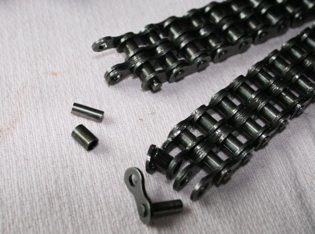

Stripped a 302 last week and found this.... doh!
Or maybe sliding the tires and swinging the car backwards, to cause the engine to rotate backwards?
Not sure, but something had to put a horific bind on that chain.
something had to bind for that to happen.
Spot on Gordon! - but not what I could have anticipated.... or imagined for that matter.

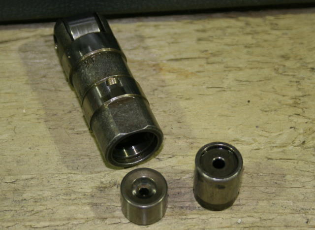

Turns out a hydraulic lifter had exploded and its inner piston found it's way into the timing cover and into the gear/chain mesh...:eek:
Thing is, ALL parts were accounted for when engine was buzzed.Only one lifter had 'popped' and all its internals were located in the valley (all 16 were replaced regardless). Then 0n removing the sump, the errant 'rogue' lifter part was located, complete with 'bite marks' where the crank gear had 'chewed' it as it broke the chain..
What's even stranger, is this engine prior to end of 2006 had solid lifters for the previous 3 or 4 yrs, so the rogue lifter part must have been 'hiding away' somewhere in the top front of the timing cover for all that time and just happened to choose the other day to say 'HELLO'. Engine had run for about 15 - 20 mins after replacement lifters/valves fitted.
Replacement parts on their way and no other damage found.
Pic shows the complete lifter + the 'rogue part' (on the right)..

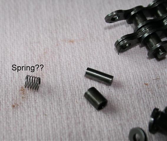

Also, second pic shows a 'spring' I also found in the sump, god only knows where it came from as it looks too tiny for any engine component I can think of... any ideas guys?

Paul,
That's the leak down plunger spring. You also need to find the check ball(little ball bearing) check ball spring (very very small spring) and check ball cage, which is a small stamped cage that holds the check ball and check ball spring to the bottom of the leak down plunger.
These parts are so small they could be any where, look carefully until you find. Yoe might have lost them draining the oil.

Thanks Jim,
I did find the main spring from the recent faulty lifter, + the ball, + the little cup you mention, but have also found this small spring and it is tiny, so I guess it could be what you describe. The real problem was we were not expecting to be looking for bits additional to what should be fitted. i.e. having '17' lifters in the engine is somewhat unexpected...

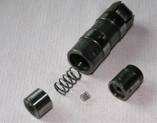

Below is the recent lifter showing the relative size of the 2 springs, the little cup and ball valve are not shown but were located still in the valley.
It still just amazes me that the 'rogue' lifter plunger has been hiding within the motor for several years....
