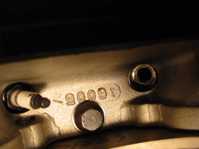

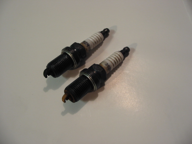

Thanks for all the input. I am going at this slow. So here is a bit more info.
I have driven another fifty miles or so since changing the plugs. It runs just fine. Pulled a couple of plugs tonight and the problem cylinder is already getting grimmy and the other is slightly tan and dry. So the problem was not something simple like a bad plug.
But what was interesting was the puddle of oil at the spark plug opening. All around it was dry. Oil only in the spark plug hole. The threads were oily the full length.
I took pics of the original plugs, one good one and the bad one. Also some pics of the oil around the plug hole. Any thoughts?

In your second photo it is either #2 or #7 cyl that has the problem, at least that eliminates the possibility of oil from the rocker shaft gallery being the problem ( unless there is something really crazy going on ) as the oil feed is above #3 &#6.
It's fairly obvious that quite a lot of oil is being introduced somehow and what you see of oil being forced up around the plug threads etc is common in this type of situation as that plug will not be firing full time in order to burn away all of the oil.
Along with all the suggestions so far the valve stem seal & or intake gasket are the most likely culprits- I dont know what the warranty situation is with your engine builder, but would suggest that you contact him sooner rather than later, If its a stem seal its a relatively simple matter to pull the rocker cover & shaft assy & replace the seal using a KD tool & a piece of nylon rope /cord. I know that if I had built the combo for you I would prefer to find the cause of this before it develops into a major problem.
