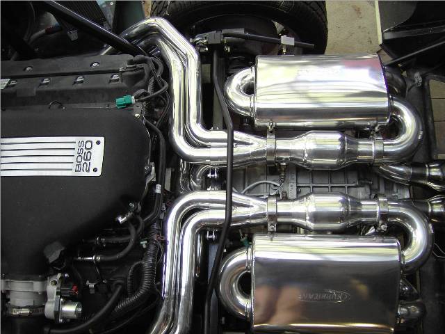

In Australia we have to fit cats but the dont need to look ugly if they are done the right way.
I have attached a photo of my system.
If you need to see more check my build thread.
Dimi
