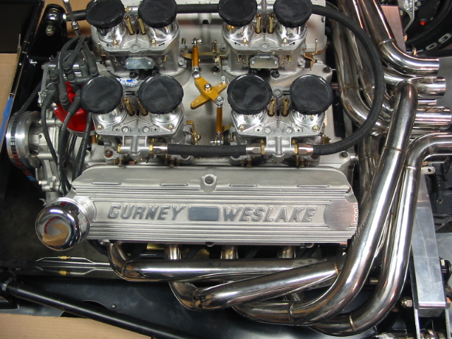

I have the Dart Pro 170 heads and the headers supplied by Fran seem to fit. I have not yet bolted everything down so this is a preliminary assessment. They are a bit tight around the left valve cover, but I do not anticipate any significant problems. So I would not be too concerned if I were you, at least not yet.
For some reason my response to your PM was blocked.
Chuck

Chuck - Thanks for your message.. I've no idea why my PM box would block your response as it was not full. I've done a little cleanup there also to give it even more space. RE: Your header clearance - It appears that the tube for Cylinder 7 was mis-positioned as there is room to get it a little more cozy to #8. I'll take a look at mine when I get out into the shop later and report back..
Bill - I'm wondering if you can assemble the tubes into the collectors and splay the header flanges just slightly while installing them as a unit?
