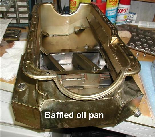

Kevko has a nice one. Multi baffled, comes with pickup. The inside pic doesn't show the scrubber that eliminates a lot of splash. It's off to the right of the oil pan.

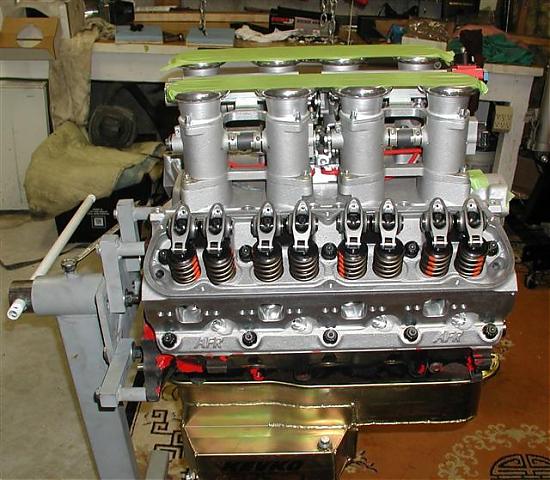

This is what I ended up with. As I recall it is 8" deep;
Regards - Randy
