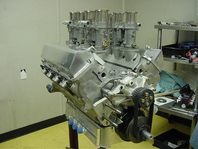

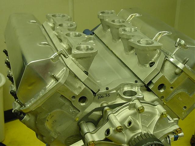

Price did a manifold for me. It was truly amazing!
