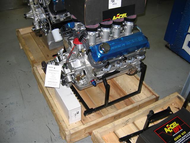

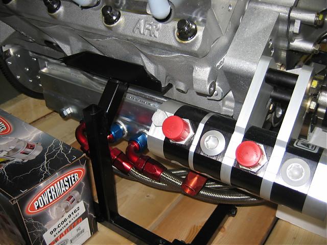

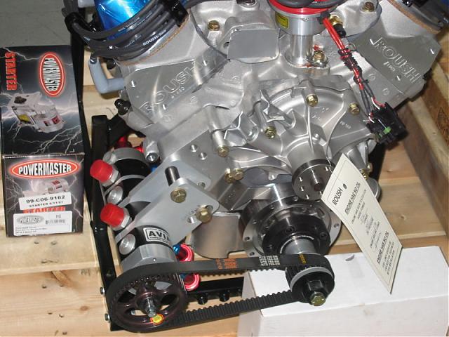

Still, whilst we're on the subject, a few pics of the motor going into Bjorn's GTD for 2008.... alloy, injected, based on a 351, 427ci and 572BHP...
