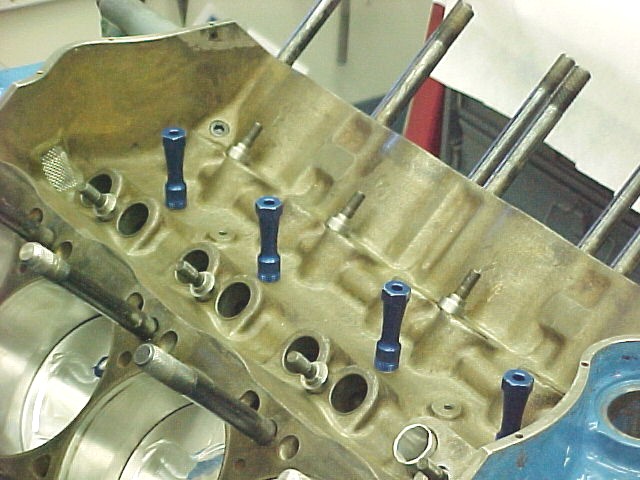

When prepping Boss 302s for TransAm racing we installed external drain-backs to the sump with AN hoses plumbed from the ends of each head. Doing this is a bit much for your application, but it sure kept the crank dry for our situation. Wet sumps were required by SCCA.
I forgot to add the picture. Notice the vents/standpipes in the lifter valley and screens in the corners for oil drain-back on this block prepared for Busch racing. The photo is from page 144 in "The Racing Engine Builder's Handbook".
Busch cup car -only turns left, therefore preferred drain is to RR corner, road race application would probably use both rear drains.
Jac Mac
Jac Mac: Correct. I neglected to mention that little detail. As for Busch cars only turning left, they do run a few road courses, so different engines are usually used. Another detail of interest to note are the Jesel Dogbone roller-lifter guide-plate studs and spacers between the lifter bores.
