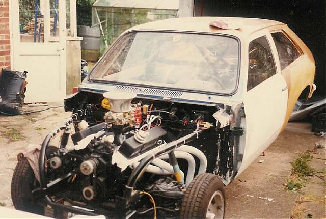

Back in the day I had my headers sprayed with a molten aluminum process which came out white (as seen below) and was extremely durable. The VHT paint doesn't last long but as has been said - cheap to repaint..

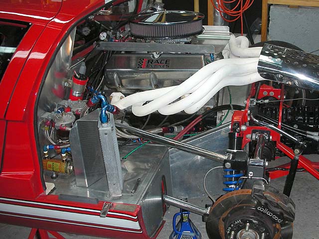

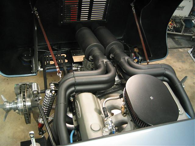

Originally Posted by Big-Foot View Post
Saw a set done in Black Ceramic coating and they looked awesome..
That's what I did with mine.I'm very happy with them.

Re: Exhaust Headers
Ron,
The black headers and pipes really set off the engiine and susppension...Nice.
BTW Interesting valve covers...What make?
Also can you provide details re the rear clip leather straps. I want to install some type of arresting straps on 2125 and yours look "period correct".
Tx, Steve P2125

My experience with VHT was that there was a run-in period after painting, and the coating was very prone to picking up stains from the installation just from handling...cleanliness was a must, but after the coating had been heat cycled it was pretty durable.
Ron...do I see some toe out in droop on your rear suspension? Maybe the camera lens, but the cleanliness and detail look super.

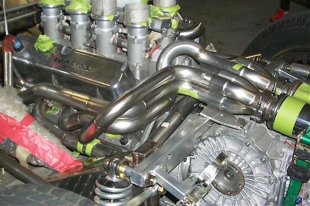

I'm kind of partial to 304 stainless and the way it burnishes with a few heat cycles.

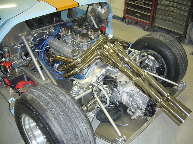

Originally Posted by Bill D View Post
I'm contemplating painting my headers with VHT white. Do you think that would look dumb?
Here's what mine look like Bill. I'm planning to replace them at some point with proper cross-overs, but won't keep the white. They get marred and dirty easily. If you do them yourself, you can always change it later if you don't like the outcome.
Mark Charlton
____________
GTD40 #09988
71 DeTomaso Pantera
70 DeTomaso Mangusta
Mark Charlton is offline

I like the polished crossover system.

Steve,
They look familiar....sorry I missed your call the other night...
