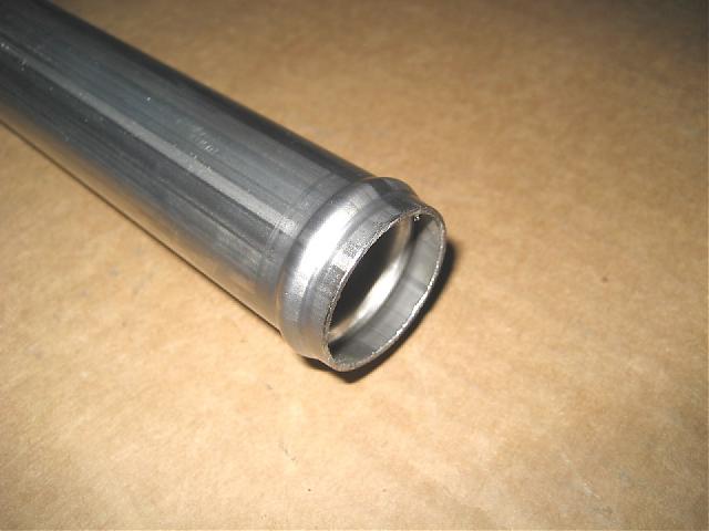

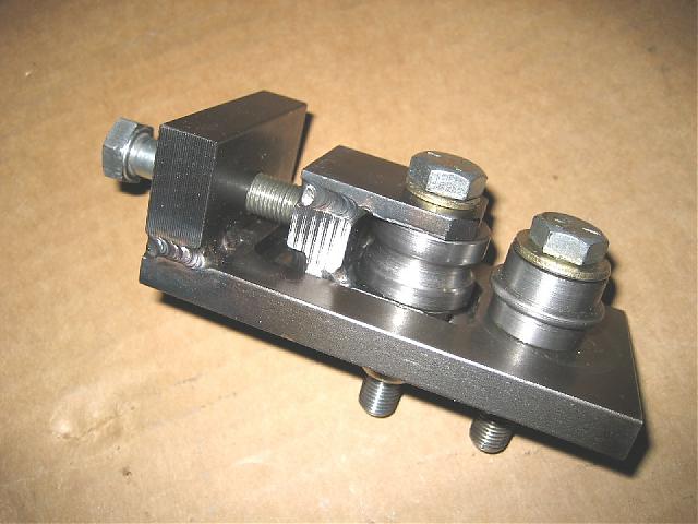

I fabricated a crude beading tool and used it on 1 1/4" diameter stainless steel tubing. After making 20 or so coolant pipe beads, the rollers started to show signs of wear suggesting they be made of a heat treatable steel. An alternative would be to use a heavy walled short length of stainless steel tube (or aluminum if that's what you're system is made of) and machine a barb/bead and weld it in place.
