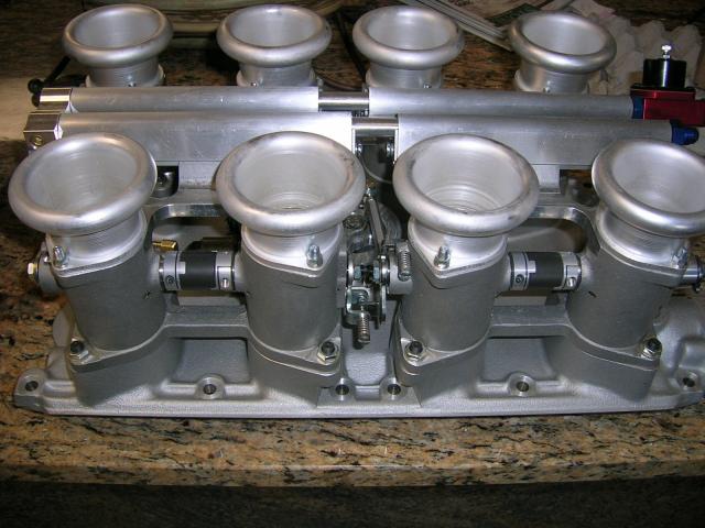

Well, I had webers and sold them to Randy as they would not clear the deck lid on my Mk1 and there was not any room for the air cleaners even if they did fit. I went with EFI TWM throttle bodies with 45 lb per hour injectors on my aluminum block 427. This is not my first rodeo with EFI so tuning was not bad. With speed density EFI and any engine with a cam the manifold pressure jumps around, with Electromotive EFI they have a blend funtion which you blend MAP sensor with the TPS sensor which is a pretty stable output at engine no load conditions which enables you to have a stable EGO signal at now load conditions (cruise or idle). I don't have a problem with webers at all and most of the Ferraris I have had had webers, seldom did I have or problems with them BUT with EFI you can change any parameter with a touch of the keyboard which gives you a presice tuned engine. Just my opinion. I love webers and EFI.
