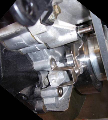

My Ford Racing engine has a Canton sump, the timing case had a hex plug in place on delivery
Stephen
