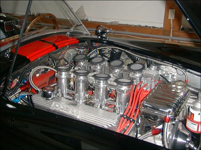

Gary Polled the owner of TWM and designer of the throttle bodies was one of the first people to import Webers into the USA for racing (TWM "The Weber Man"). He also invented the SK carb. At the time that he made the throttle body, he was not thinking of the replica market, he was looking to the future. As for WOW factor, the throttle bodies are just a different WOW, but WOW all the same!

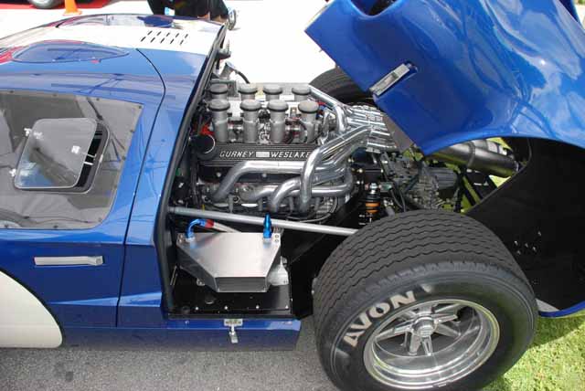

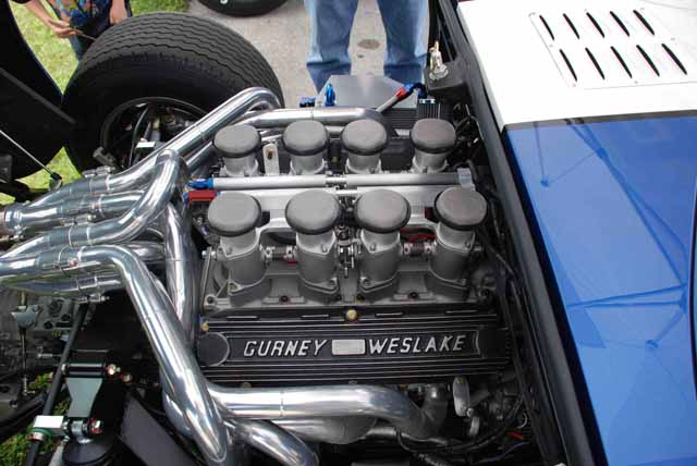

Here's another look at the TWM setup using their 'Nostalgia Look' Weber-style velocity stacks. They use tall stacks in a brushed aluminum and have a very 1960's look - no polishing here! I installed them on SPF P/2192.
