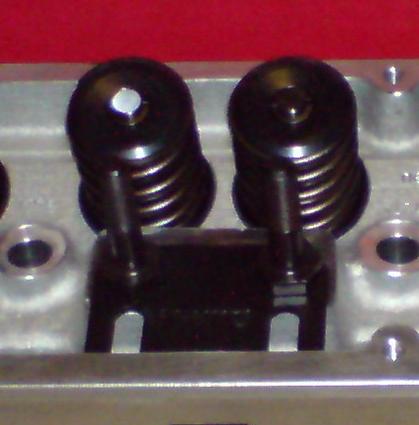

jac mac, they are studs as as supplied assembled in the head. There is a threaded sleevenut with a grub screw in the thread which locks against the end of the pushrod stud.

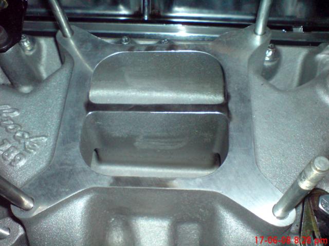

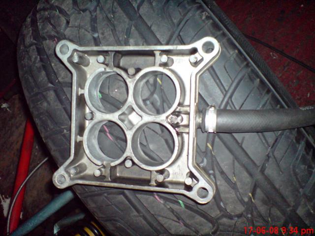

So next I removed the carb and spacers looking for air leaks, then I spotted soot marks each side of the manifold face, you can see in the first picture. Then, a look at the adaptor with the breather pipe shows that it overlaps the Edelbrock manifold letting air in on both sides. The face on the stock manifold is bigger and it seals ok.
So, I ditched the breather adaptor, cut some spacer tubes for the carb mounting studs, and reassembled with the tapered carb levelling spacer only. Now ticks over fine, and I will sleep well tonight! There is some tappet noise, so I will go back to the 1/2 turn preload, check torque the head bolts and box it up.
ID:	30487   Click image for larger version
