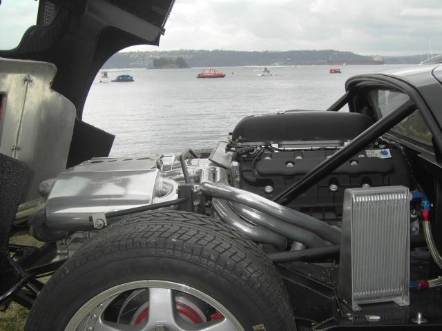

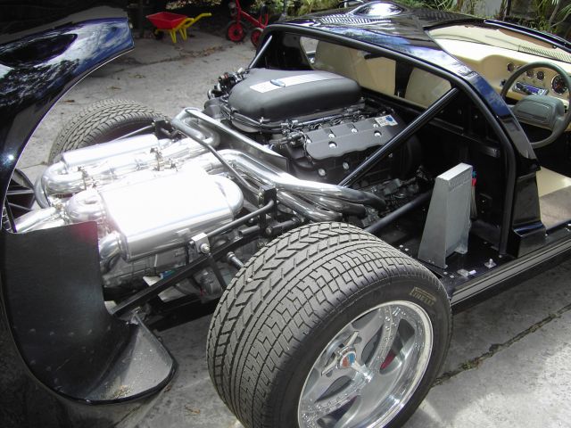

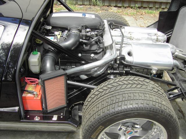

Hi Dazza
For what it's worth the decision of which motor was dictated for me by the RTA requirements and what was going to be the easiest to comply with the regs as well as what would look the cleanest without having the engine bay cluttered up with pipes, hoses, leads and wires going everywhere.
The 5.4 Boss motor with the standard Ford ECU complies and does not have to be emission tested and is also a clean and uncluttered looking motor.
The other big factor is that a GT40 with a Boss motor registered in NSW can be sold in any other state without any problems unlike the situation that exists when trying to bring an out of state 40 into NSW and trying to get it registered which is next to impossible.
Photos of the 5.4 in my car are enclosed.
