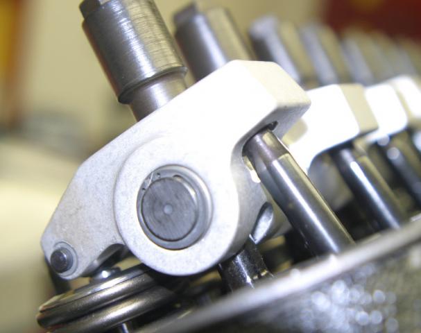

JacMac: We always do a preassembly to recheck clearances just for this reason, especially the valve train. Fat aluminum rocker arms, large-diameter pushrods and high-lift cams combine to close up clearances at the pushrod and valve-spring retainer, so we check clearances with the valve on the seat and fully open. We do this check regardless of rocker-arm manufacture.
Similar to the problem you found, here's a roller rocker we found to have a pushrod-to-rocker interference in the valve open position. We clearanced the rockers using a light touch with a die grinder and burr.

At first glance one could draw that conclusion from the pics and it is hard to 'see' the difference between the correct/incorrect rockers at first glance. The damaged areas resulted from the pushrod cup literally 'shaving' the alloy while running rather than pounding into a solid area, even if the pushrod was 0.050" shorter it would still have interfered on the 'bad' rockers, also that would give a less than optimum wear pattern on the valve end and when the adjustment screw is extended to match a shorter pushrod it increases the chance of it coming loose in service from the extra side loading @ full lift. The other rockers that had been correctly machined for clearance have 0.040" clearance between pushrod cup and rocker body thru the full lift cycle. I have simply modded the 'bad' rockers to match the good ones. As installed now the 'wear' pattern on the end of the valve stem is 0.050" wide and centered.
