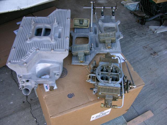

I took this thing apart this evening for a peep inside.
It's much better made than those Webers in my opinion.
Now I can't wait to try it.

James, Im not sure but I think you will find a lot of small parts are similar to those in the 1100/2100/4100/4300 series Ford/autolite carbs- yes even the single barrel carb fitted to plain jane escorts/cortinas/capris with x/flow pushrod motors. stuff like acc pump diaphragms etc.
JimmyMac
Jac,
I guess that you are correct.
The box of spares that came with this piece was pretty comprehensive and some of them looked familar. I have an old Ford/Autolite carb spares catalogue somewhere so I will have a look this weekend.
Looking at the water passage modifications to change the set-up and fit from Cleveland to Windsor heads. Otherwise I will make a new lower manifold to fit the Windsors - interesting Ford stuff.

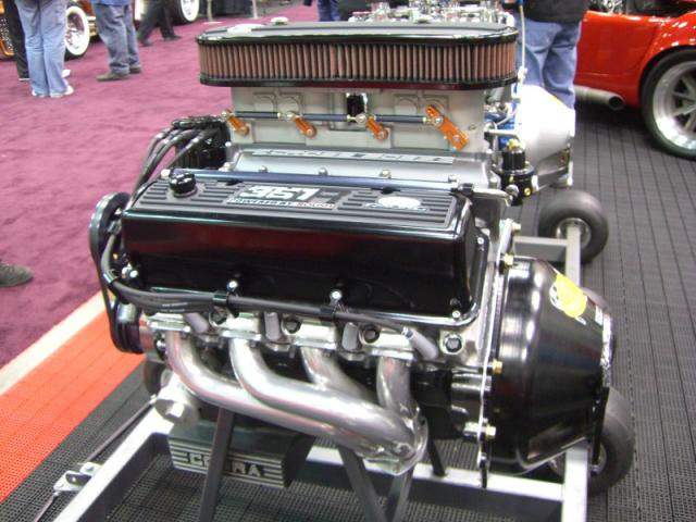

There is a fellow on the ClubCobra website that is running 2 of these on a specially designed manifold on a 427 FE. He made some very nice air filters for them too.

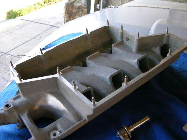

Here are a couple of pictures of the plenum inside the Cross Boss manifold.
There are lifts in the casting at the top of each port.

JimmyMac - We're going to test JacMac's memory here as mine has suffered terminal fade but I remember some years ago a well known tuner had modified a set of heads to produce that same effect only IN the port itself.Reasoning was that it produced a turbulence causing the flow to turn more easily toward the entry around the valve and keep the fuel in atomization - that sort of 'kick' in direction that Jac had mentioned. A.J.
A.J., That wouldnt surprise me in the least, there have been many different approachs to this, Think it was either AFR or Brodix that applied 'dimples' in the valve throat & chamber walls to create turbulence for this reason, Im sure others were doing similar tricks to achieve the same. Must be nightmare for the cyl head manufacturers to build a product where 'one size' fits all ( disregarding the common intake port volume designations ) as most people opt for -bigger is better-. Often not the case particularly in road racing.
