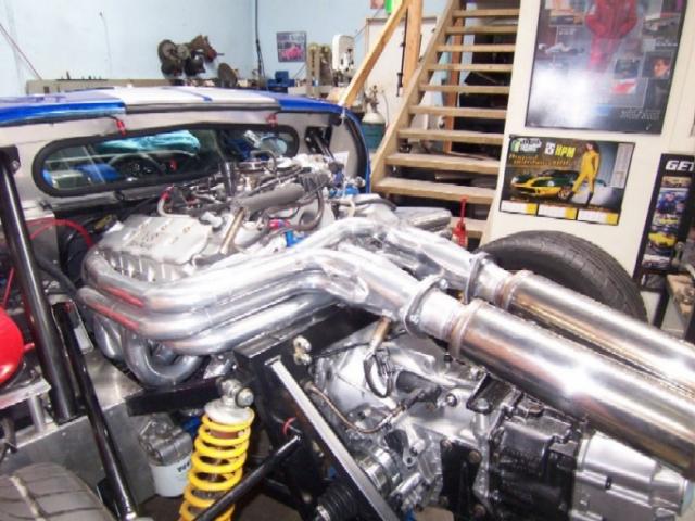

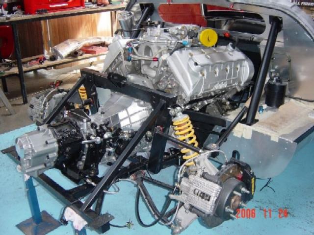

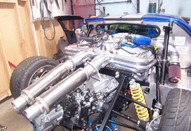

We used existing engine sump and modified it and the pickup to The New Roaring Forties dimensions to give us the ground clearance. The sump mods seem to be working fine. The engine is coupled to an Audi 016 6 speed gear box and although the engine is a neat fit it's not too bad to work on. If you like I can send you more photo's of the build to help you. The New Roaring Forties and Will Croll Engineering may also be able to assist you as they have the complete design specs as well as all the available parts for the car. I haven't done a fuel trial run yet but I know already that it's not too bad. At 110klm's/Hr it's sitting on 1850rpm.
Regards
