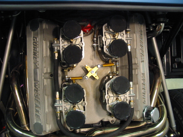

The reason there is no PCV is the lack of a good vacuum port on most weber intakes or carbs. (just a guess) |
29th December 2008, 10:44 AM
#11 (permalink)
| | David Briggs 6 Tenths
Join Date: Apr 2004 Location: San Diego GT40: SPF MKI #2214
Posts: 684
| Re: Breather Cap: One or Two? That intake looks like it has a plenum chamber and should have plenty of vacuum to operate a PVC system which will create negative pressure in the crankcase and remove moisture and keep everything cleaner inside and out.

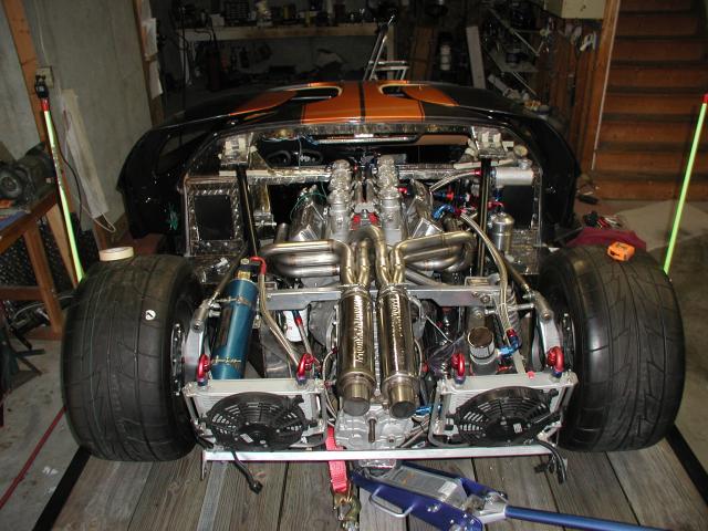

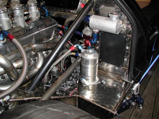

| Re: Breather Cap: One or Two? Here's how I did mine. The fitings are AN8. I did this because I knew I would need to vent to a tank if I ran it on track.
It does seam to work. I find it interesting that Jac thinks two AN10's are the way to go. I have noted the AN10 point and as it is said by Jac it shall be done on the SC-C 350 chevy now in progress. |

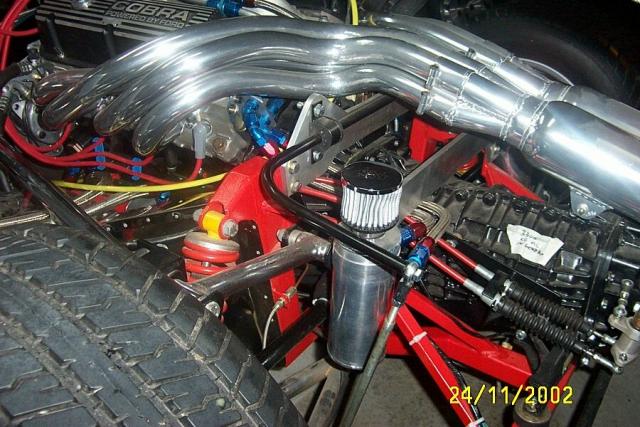

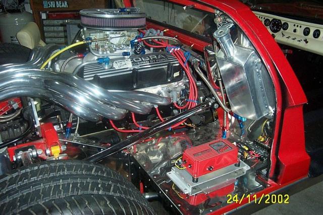

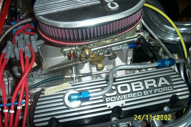

| Re: Breather Cap: One or Two? |
6th January 2009, 08:24 AM
#20 (permalink)
| | CESLAW Gold Supporter
Join Date: Oct 2006 Location: Illinois GT40: RCR
Posts: 1,319
| Re: Breather Cap: One or Two? Rick: that is a gorgeous looking set up. Very original looking. |
