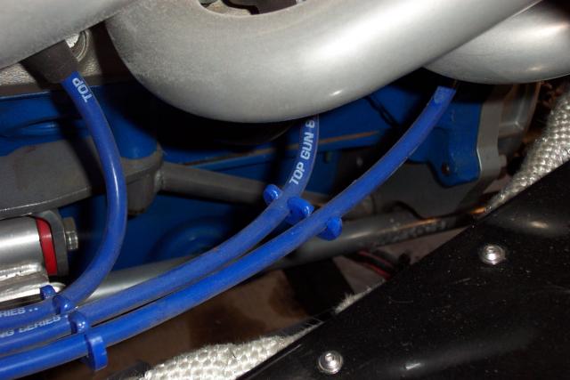

Ian, Urethane "solid" mounts seem to be fine on my DRB - no vibration issues at all. This is the standard setup for DRB's with SB.
The attached pic shows the end of one mount, along with the bracing strut between the engine mount & the g'box adaptor plate.
Sorry I don't have any decent pics of the full mount - let me know if you need better ones.
