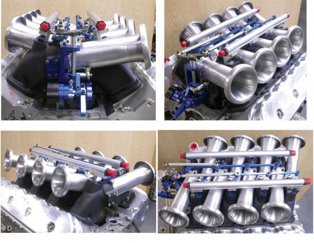

Kinsler crossram intake. Functional as well as pretty. It even hints at the curved trumpets of the original motor.
And I would try to do the coil pack relocation and get better looking valve covers. Katech has this type of stuff.
