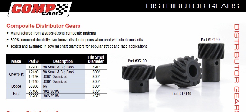

This info from Comp cams may help
Personally I prefer the ones listed in the Ford SVO book - after all, the 5.0 roller cam engines run hundreds of thousands of miles without trashing their gears. In the past I have started with a stock 5.0 roller cam and had it custom ground and re-hardened - This combo goes well with even with the stock 5.0 gear - never had one fail !!!!
Cheers Kevin B
