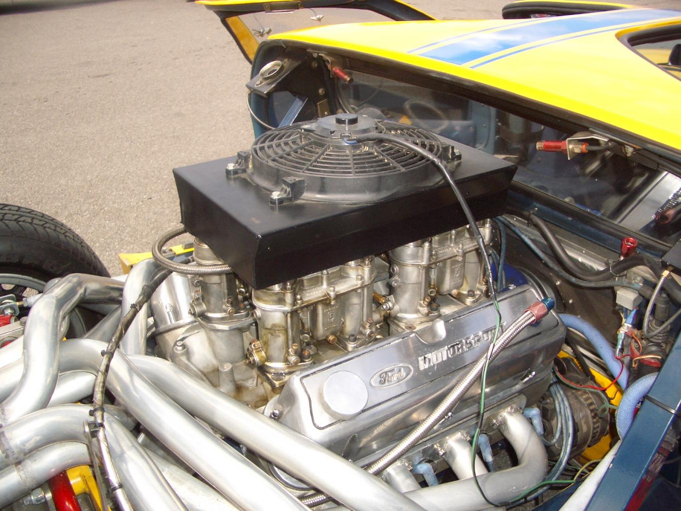

| Re: Carburator base insualtion gasket? I know this shows it on webers, but we use a fan box on top of the carbs fitted immediately after coming off track to draw excess heat away from the carbs, only needs to run a few minutes to prevent fuel vapourisation, works well. |

good idea for track use, but unfortunately not very practical in daily situations. Any specific reason why you are not using a turkey pan to shield the carbs a bit ?

| Re: Carburator base insualtion gasket? TOM, OWNERS PREFERENCE, all other cars have turkey pan, Frank |
