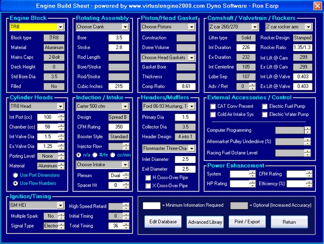

Well using what info you give I get Bhp 237/ Tq 207 @ 6000 , peak Tq 228 @ 4500. Usefull info to make it more accurate would be valve sizes, lifter type, dual or single plane manifold, cam intake and exhaust duation @ .050 and
lca. The prog I have is crude but it does the job.
A poor dual plane intake, and hydraulic lifters, flat tapets. I'll get the cam specs and flow numbers tomorrow AM. Thanks for giving it a shot!

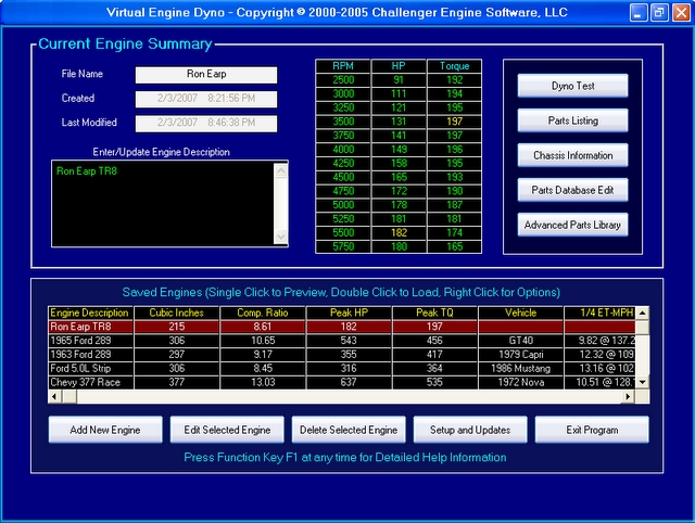

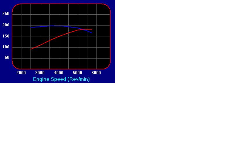

I know these programs vary a lot in their accuracy, so here is what I got (using only the one flow value) that you can average into the mix...
I noticed after I ran the numbers that you mentioned open headers into 3" collectors, this boosted the #s to 183HP@5250/198TQ@3500
Al
P.S. I know you probably don't care, but it should run a 15.29 Quarter mile @ 87.6 MPH based on published weights (the car's, and yours :))

No stock info for the TR8 cam, but I will see what I can dig up. Most simulators (at least in the range that I can afford) are really best used to compare the relative difference between scenario A vs B, and are not that great at giving you a right on-the-money HP and TQ curve.
If I had the opportunity to choose, using the program in "the space between Jac Mac's ears" is what I would go with!
Al

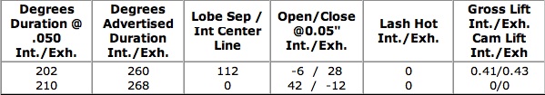

Most of the "stock" replacement cams for the TR8 I have found fall into the range below.
Al

your cam numbers match what it in the TR8 book so that has to be it, but I'll find all the real specs for it. Compression ratio has been calculated and heads cc'ed, gasket taken into account etc - it is right at 8.6:1, actually a tiny bit over like 8.62:1, but that is the max allowable. The primaries are actually approximately 33-35" long, or thereabouts, not what I estimated eariler. Pulled a tape down on them when I was undoing the exhaust today.

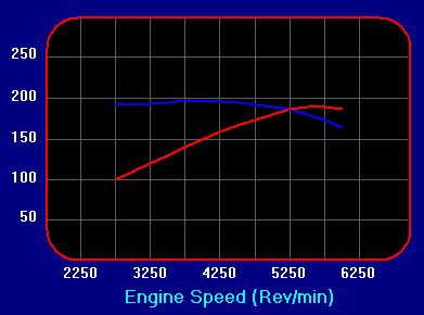

Using your flow numbers and bumping up the CR to 8.62 gave these results (1 more lb-ftTQ)...
Al
