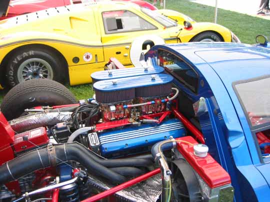

This angular scoop really pulls air into the cockpit through the sliders.
