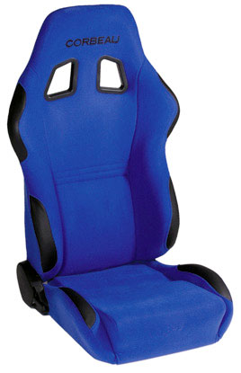

If you would like to get aftermarket seats, the Corbeau A4 is a reasonable priced seat that fit in GT40s; ~$325-350.
Click here for Corbeau A4s at Automod
Regars,
Lynn

Yes, I have the Corbeau A4s in my car. It was one of the few affordable seats that would fit. My seats are black as that was the only available color at the time. If I hadn't already put Ben's big GT40 Logo patch right between the shoulder blades on both seats (bonded and stitched) I'd sell them and get the blue ones, which would match the car color better. They do give you really good support.
They also fold forward and backward. This was a requirement of mine since I placed the computer, inertia switch and most of the relays behind the passenger seat. In addition to providing access to behind the seat, they also will lean back to match the incline of the firewall.

The sitting height off the floor is only a couple of inches. I quickly realized that this was the most restrictive dimension, believe it or not. I had some early model corvette, lumbar split seats that I thought would be perfect. They were, if I wanted to drive with my line of vision 2" above the roof!
Go here to get all dimensional and other info on the A4:
Click Here For Corbeau A4 Detail

Well all you guys, I stopped by to check out the seats today. I didn't bring my CAV, but I think that you all will be happy to know that the "A4" is 17" from side to side on the floor. 6" off the floor is 181/5", but can be squeesed in because of the foam padding. Don't jump to buy this seat yet, because I think that a much more comfortable seat will fit our GT-40's. I think it is 18" on the floor and has an adjustable head rest which can be removed if it is to high. If it does not rain Saturday ( 12-20-03 ) I'll take my CAV over there and try to fit as many different seats in it as possable. Then you all can have a better choice. I was told that if we get a bunch ordered they will give a much better price. I'll get back intouch Saturday night and let you know what happened.

I did sit in the A4 in the store on the floor and I did seem to compress the seat almost all the way down to the metal frame. The seat cushion was fairly soft so it should not hold you off the floor very much. It did seem to be comfortable though. Joe [img]/ubbthreads/images/graemlins/laugh.gif[/img] [img]/ubbthreads/images/graemlins/laugh.gif[/img] [img]/ubbthreads/images/graemlins/laugh.gif[/img] [img]/ubbthreads/images/graemlins/laugh.gif[/img]
