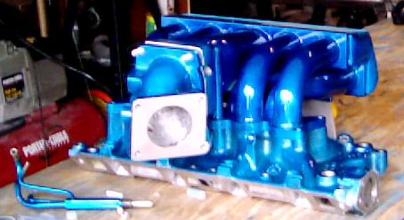

Ron, thanks for the offer. I baked them for a while last night hoping that would cause the paint to peel. No such luck; although it did make it a bit more chalky.
I have poweder coated the GT40 intake. I did the runners last night and they make the lower manifold look so bad, I am going to have to try a second coat on it. The 94/95 adapter was sooo butt ugly before, anything would be an improvement. I may try another coat on it depending on how the lower manifold does.
